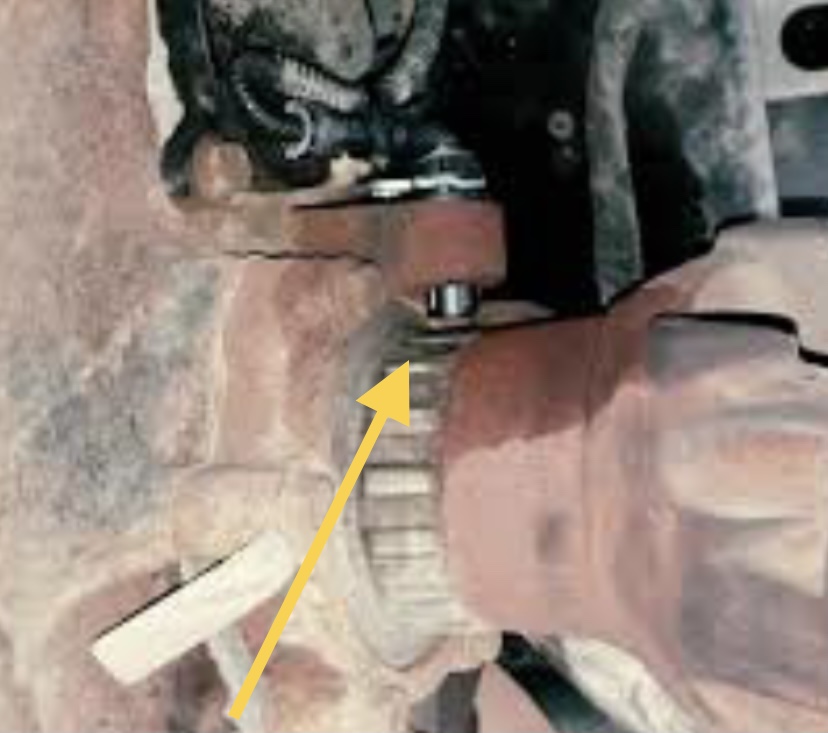

    The answer is simple, the issue very common. If there was any work performed at the hub and the ABS/TC lights are on after the repair, the sensor(s) were not pushed back in place.
    If the problem developed by itself, have it checked and fixed.
    JoeyJunk Thanks this.

    There shouldn’t be a big air gap between the sensor and the toothed tone wheel (hub…..i just wanted to sound smart) . The fix is sometimes simply adjusting the sensor inward to close the gap.

    Wheel end or ABS speed sensors are self -adjusting and pushing them in to contact the tone ring is correct. The endplay in the wheel bearing sets the gap. Output speed, vehicle speed sensors and trans speed sensors on late model trucks are preset to a certain gap and most are non-adjustable. At least on Eaton and Allison transmissions they are anyhow.
    Some old stuff with threaded sensors for Tach and vehicle speed are adjustable. Usually tighten down to contact the tone ring and back off 1/2- 3/4 turn.
    Very easy to knock a sensor about while changing shoes or to forget to adjust after changing a wheel seal. Some can be stuck hard with age and impossible to adjust after the drums is installed. I like to pop in a new retaining spring and inspect the sensor during a wheel end service. Sensor springs are available without the sensor.
