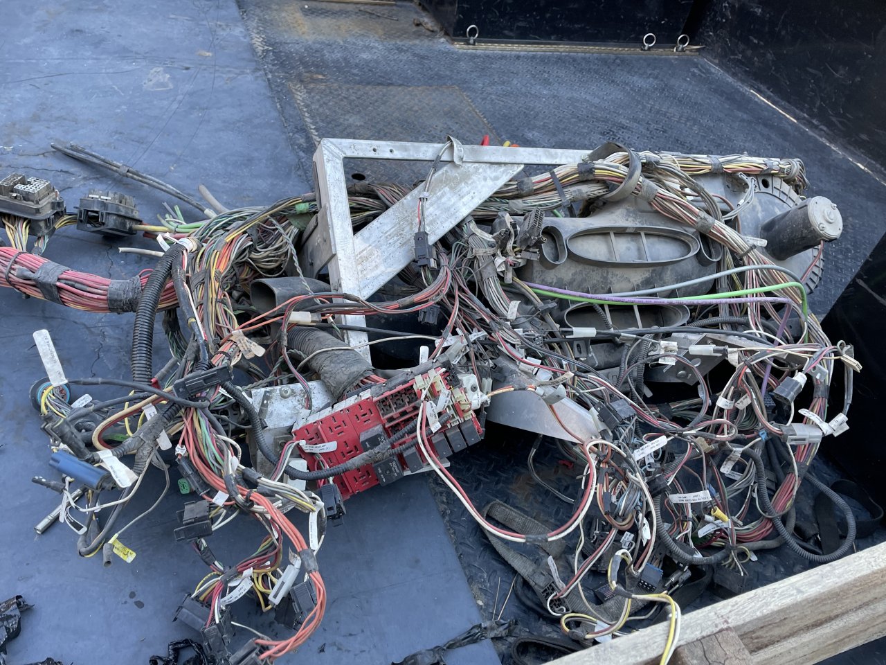

  6. welldigger00
    welldigger00 Light Load Member
    186
    1,505
    Jan 18, 2022
    BD846253-7106-4DED-B4EC-4CB43826FE0D.jpeg Check this sexy thing out. I found it at a salvage yard, and it’s totally intact. Everything I need and then some…
