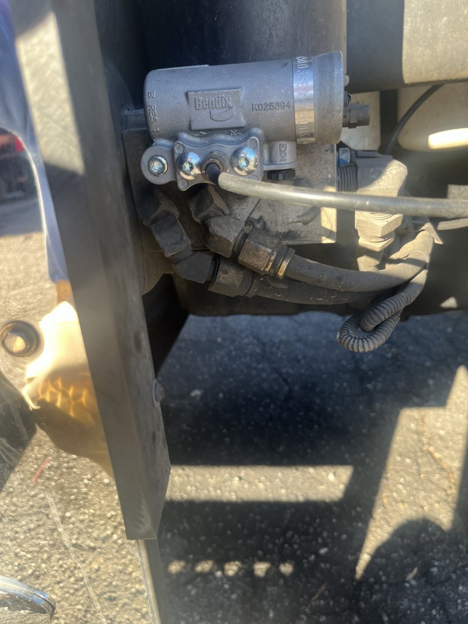

    If it's popping off at the correct pressure, that means the governor is seeing that pressure from the tank, and sending the signal to the drier to pop off, while simultaneously sending that signal into the compressor to unload.
    Yes, it can definitely build air with unloader issues.
    I'd pull the governor off of the air compressor, but leave the hoses connected. Then use the threaded pipe orifice for the unloader signal on the compressor side of the governor, and tap in a pressure gauge to verify signal once pressure hits 120, or it pops off.
    If you don't have a pressure gauge and we assume the dash gauges are correct, just unbolt the governor and start the truck. Make sure air comes out of the orifice going into the compressor when the drier pops.
    You didn't plug your signal hole to the unloader when you installed the new one, right?

    IMG_3099.jpeg IMG_3098.jpeg IMG_3099.jpeg IMG_3098.jpeg This was after replacing it. I installed it same way I’ve always done it.

    @Big Road Skateboard ... My governor is on my air dryer not my compressor. Are you saying remove the air dryer off the compressor, leave the lines attached, and see if air is coming from that port? On the compressor, which one of those is the inlet port that I need to pour alcohol in? And what's the procedure for doing this? Truck on?(after removing the line). I am gonna replace the unloader valves, and ive got a spare air dryer that I will test/put on. Ive been south all week and headed north to Indiana where its cold so im trying to get ahead of this.......FWIW, it does pop off but it does it like when its over 140 or so......
