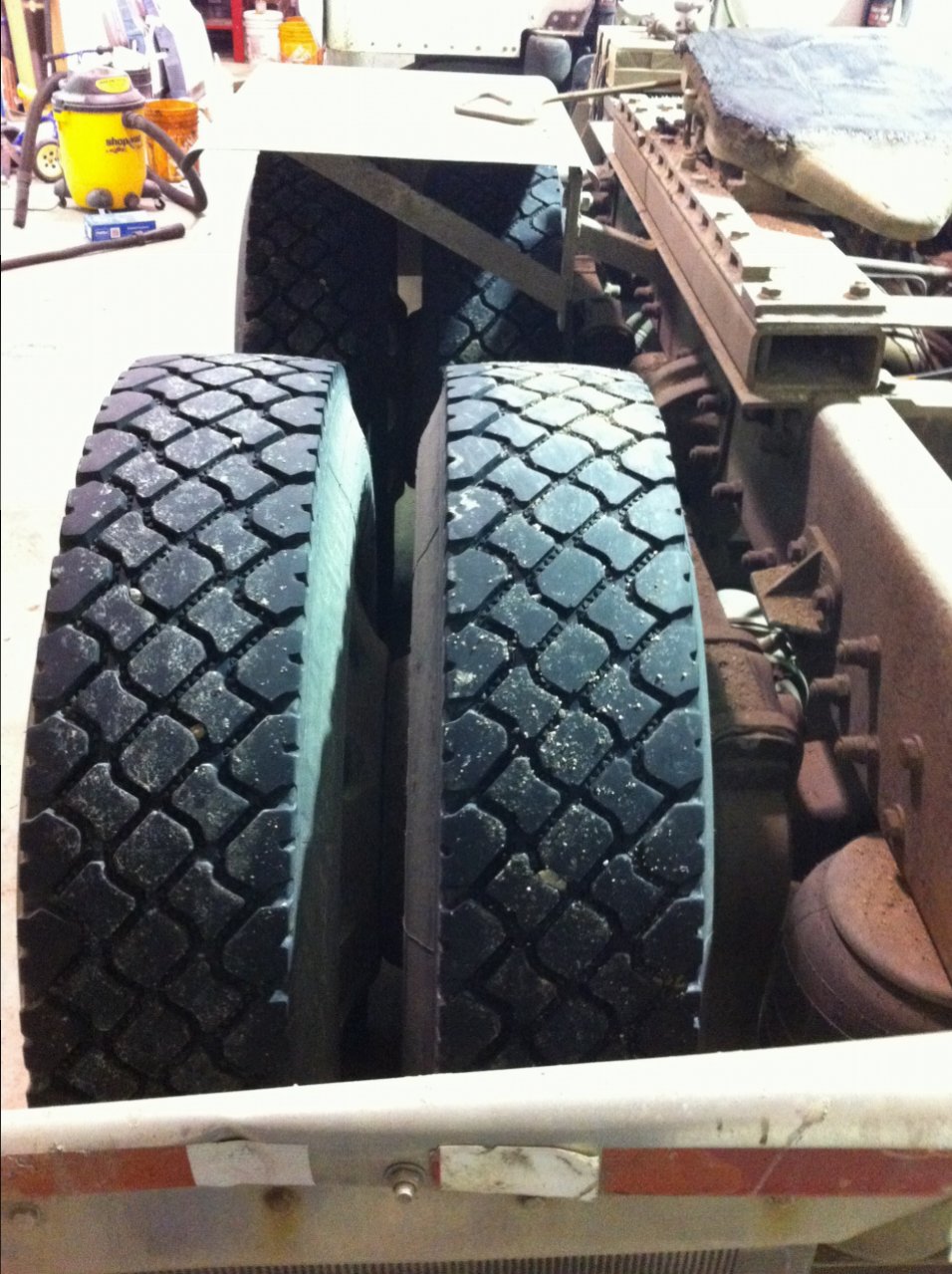

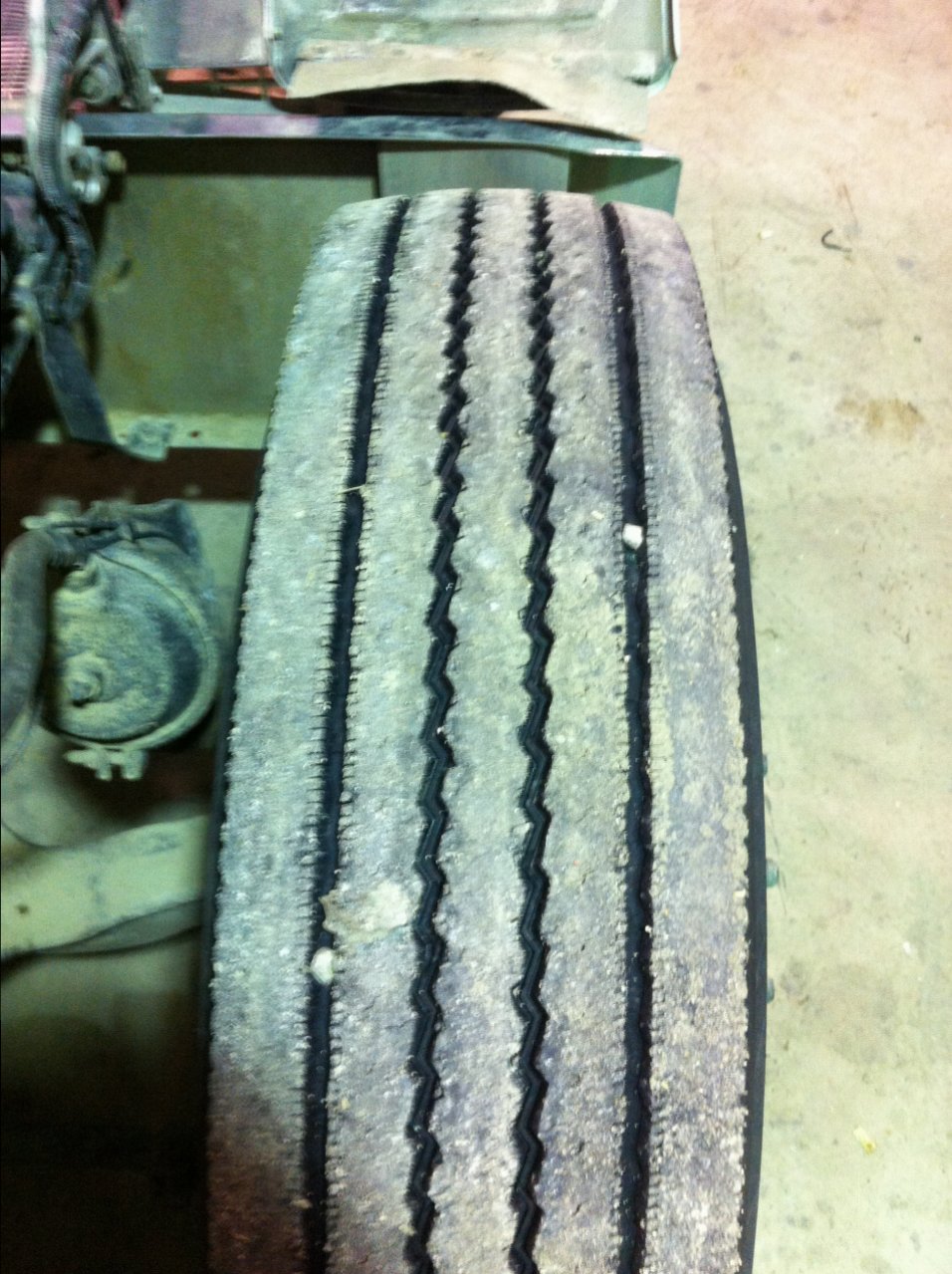

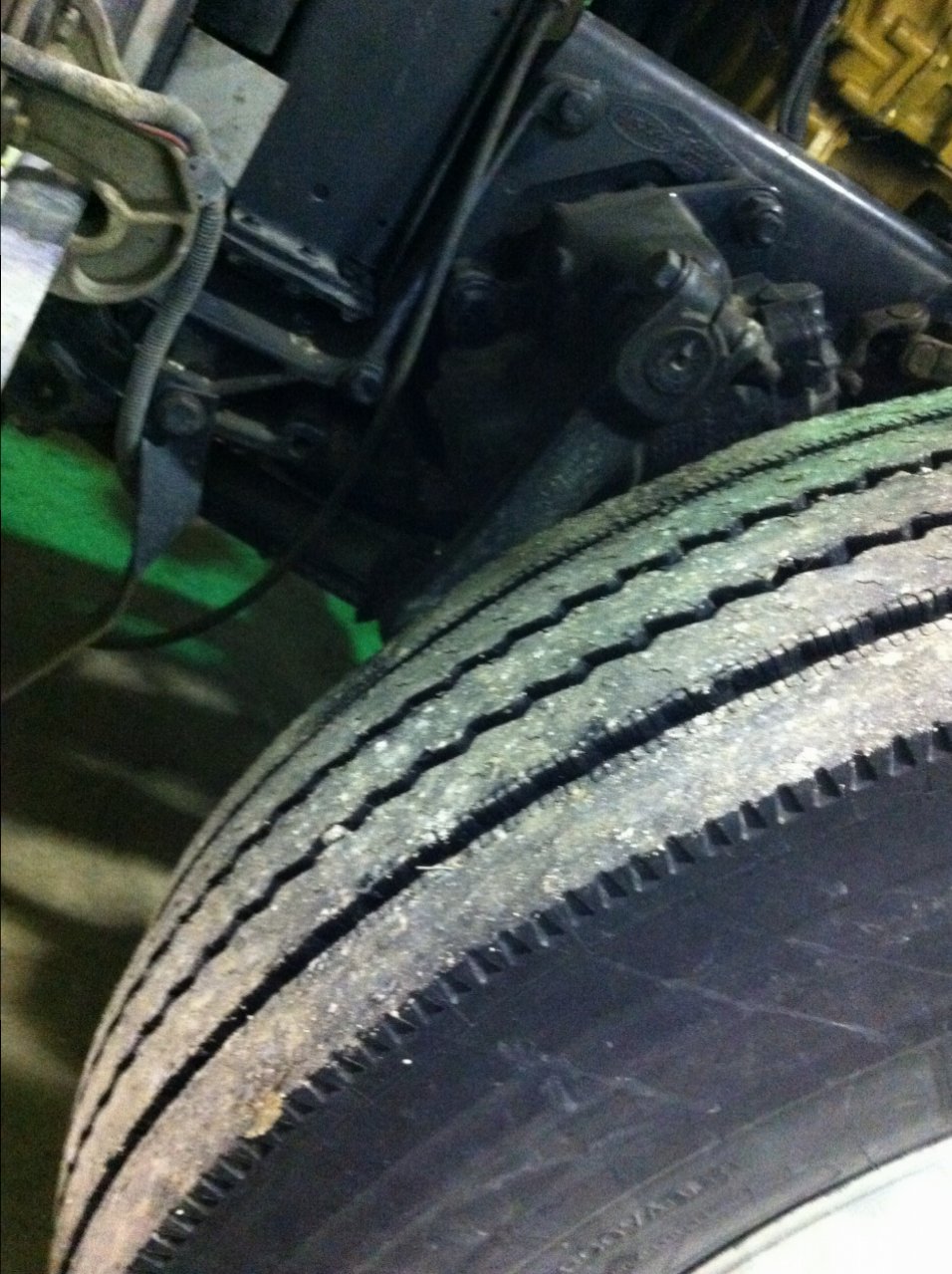

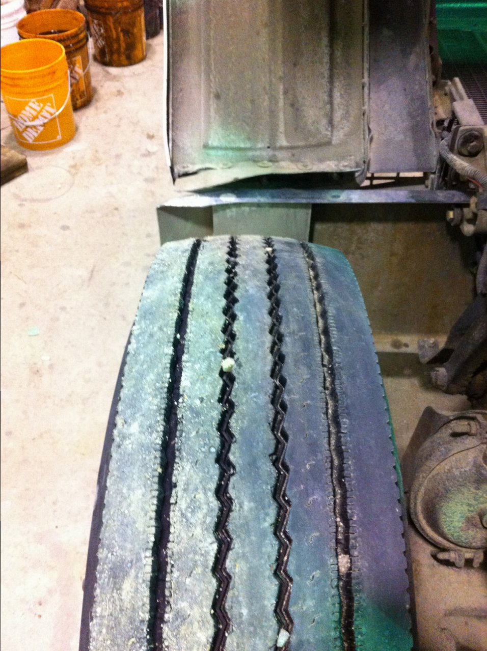

    01 Pete 379L, 244" wheelbase, low air leaf, my drivers side steer tire started to wear the inside rib, and now a few thousand miles later its also starting to cup on the inside rib, pass side is wearing nice, king pins feel tight, felt the shocks tonight and d/s was cold so prob no good, pass side nice and warm. My reason for concern is the pass side rear rear duals are wearing faster than the rest, more pronounced on the inside dual, checked the main bushings with a bar and they feel tight, shocks feel good, only real problem u can actually see is the torque rod bushings are starting to look a little sad, I'm just wondering if the driver side front cupping and the pass rear wearing could be related in any way because of thrust angles, etc? Truck handles nice on the highway, pulls to the right a wee bit but nothing drastic.

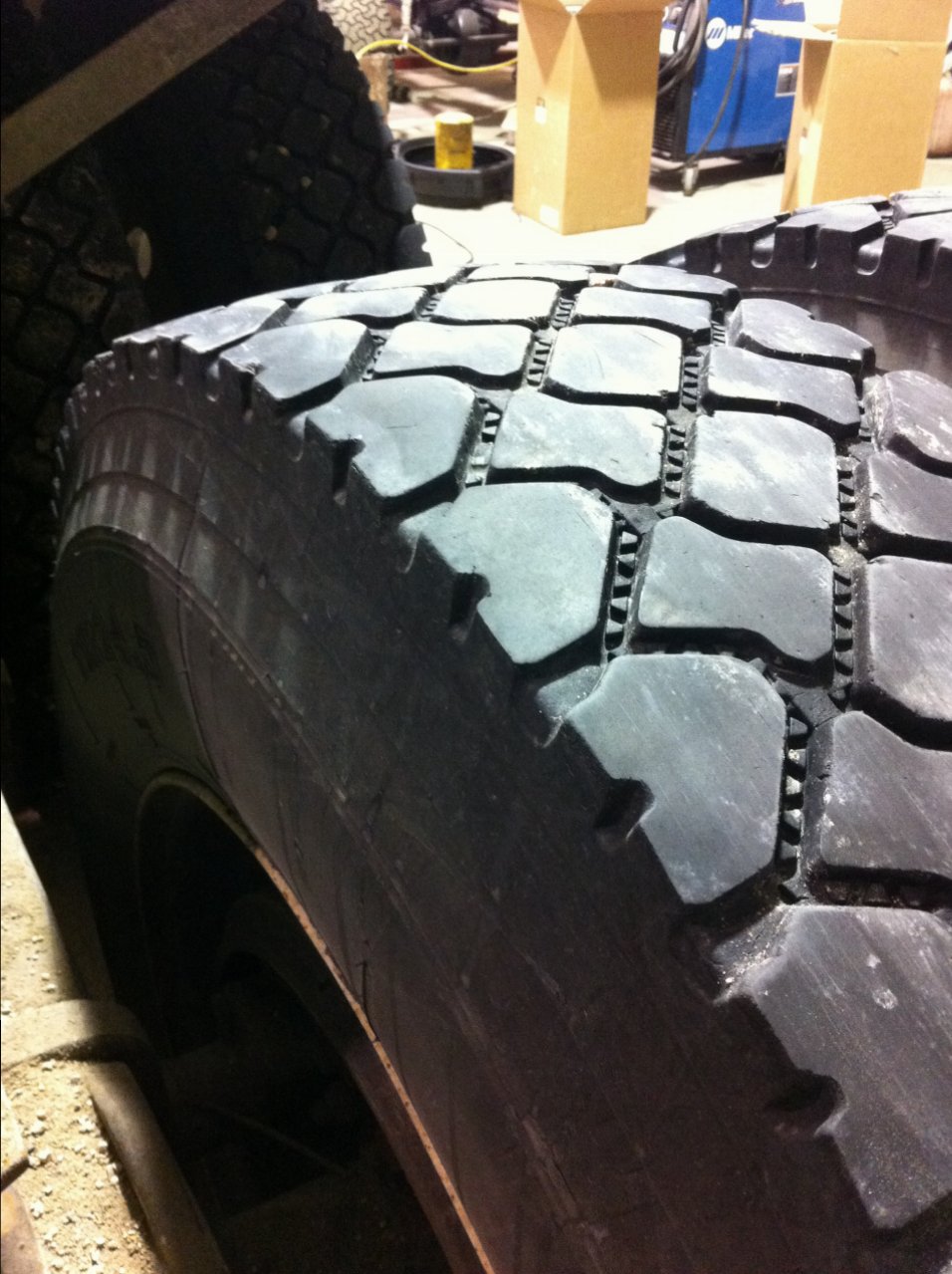

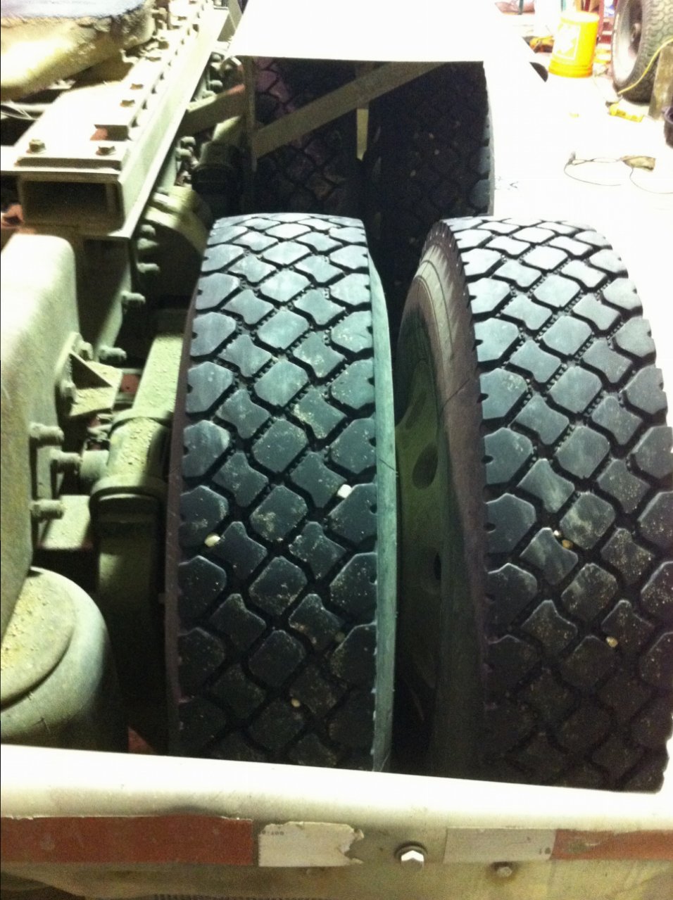

    Hard to see in the pics but the rears are worn around 3/32 more on the pass side image.jpg image.jpg image.jpg

    It almost looks like the pass. side steer tire is wearing on the outside rib a little more. Almost like you're having to steer left a little bit to keep the truck from going into the ditch. If everything is tight you may need to get your axle alignment checked.

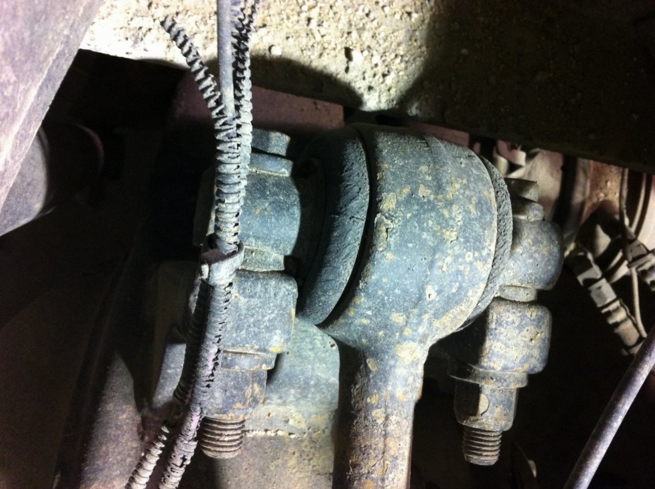

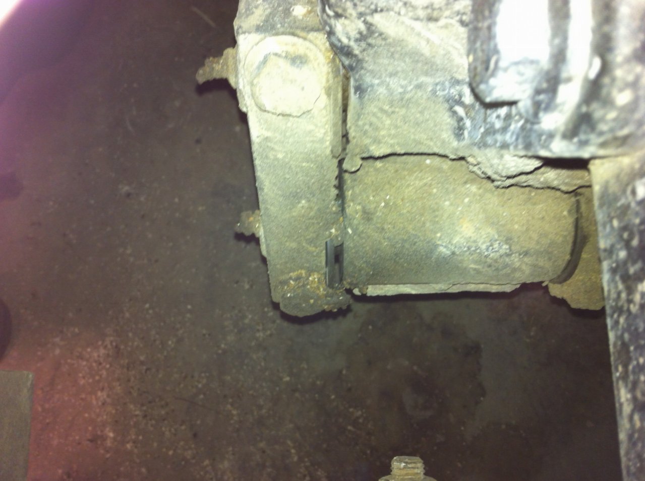

    image.jpg image.jpg image.jpg Torque bushings and front shackles, shackles have a bit of a gap, greased last weekend, 3000 miles this week

    Pulled the shackle sides off, the gap is from the washers wearing into the alluminum, bushings are shot but I flipped the sides over so at least they are tight for now
