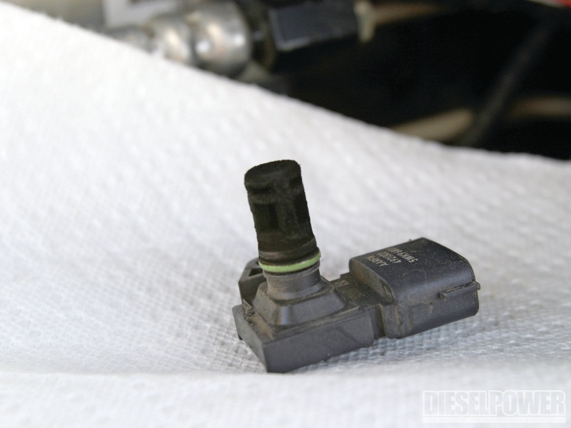

    The code is usually in error. Chances are you need the intake manifold/pressure sensor cleaned. (They are the same sensor). They are prone to plugging up with carbon. Same for the EGR differential pressure sensing tubes. With these plugged it throws everything out of wack. Also, if you are loosing coolant, they will carbon up even quicker. EGR coolers failing and leaking coolant through the exhaust is very very common on these engines. If your engine is still under warranty all the cleaning is done as part of it. They know that leaking coolers plug up everything so they take apart all the EGR tubes and clean them out. They will also do forced regen for you to burn out any coolant contamination.

  9. EZ Money
    EZ Money Road Train Member
    Thanks,It goes in the shop later this week so i will have them pull that sensor.
    If it is the one on top of the manifold i may pull it myself today and clean it.
  10. Heavyd
    Heavyd Road Train Member
    7,815
    6,267
    Feb 4, 2009
    The manifold pressure/temp sensor will have a 4 wire connector going to it. It is held in with only 1 bolt that takes a 10mm socket. The sensor comes out by going straight up with it. It will be kinda stuck so you will have to wiggle and twist it back and forth as you pull up. It is plastic so don't be too rough with it. Once it is out you will see what it look likes and how much carbon is on it. Just use a small pick or mini screw driver to gently clean out the carbon. The temp probe in the middle of the little plastic cage section so be careful not to damage it. The pressure sensor part is in the base and you can't get in there with anything. I just use compressed air to blow it out after the main carbon is scraped away. As I mentioned there is a plastic cage, with all the carbon scrapped out you should be able to see through it and see the temp probe. This is the best picture I found of one, and it is plugged too.
