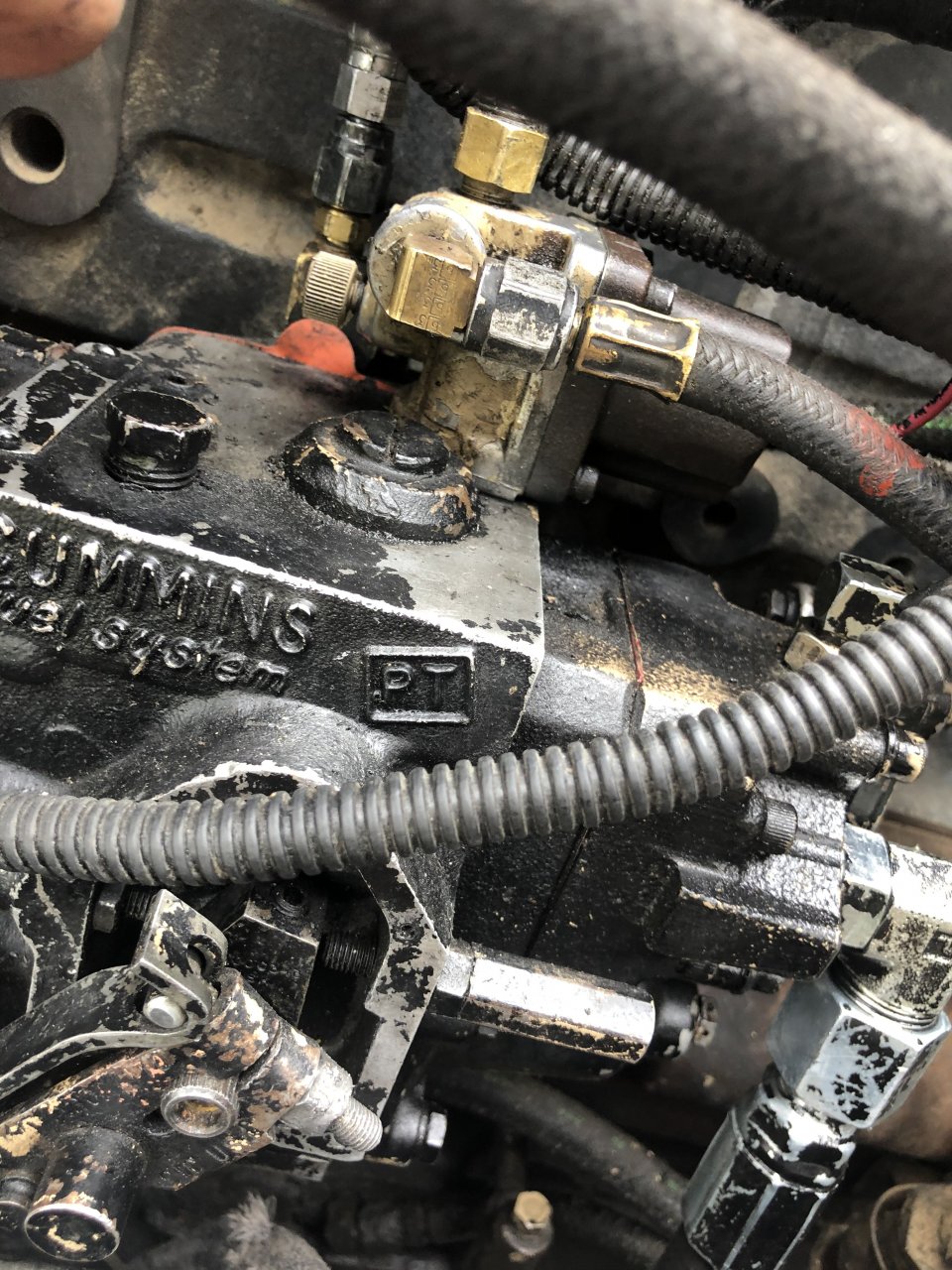

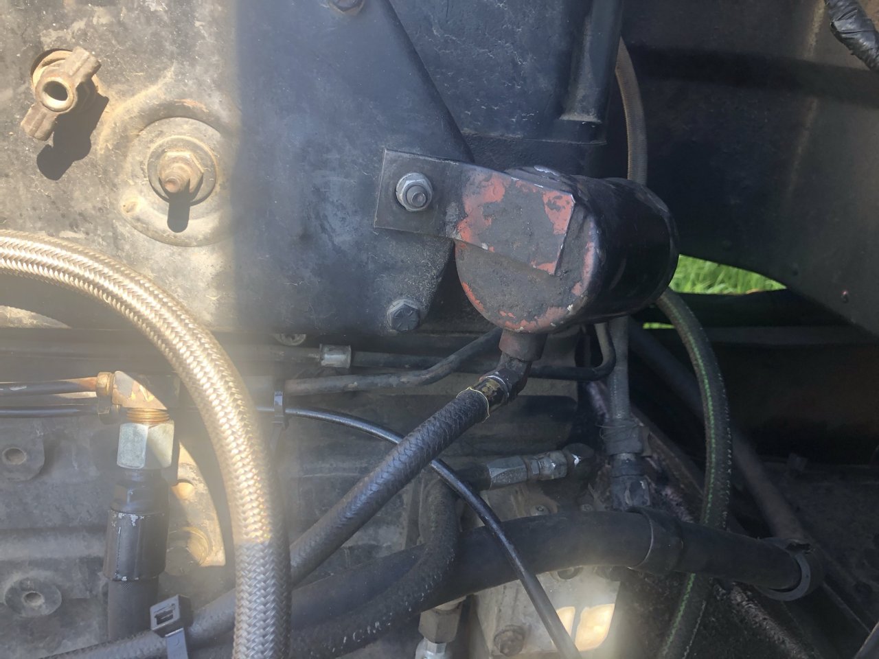

    615BCCB6-1F1F-42EB-BBFA-4C68C464DA8B.jpeg 6E624805-450D-40F2-8B8B-B97C374547B9.jpeg Thanks you very much. I will be trying these methods. The pump was taken off from a working truck and rebuilt two years ago so this will be interesting to see where the Air is coming from.
    Attached are some pictures, one of them appears to be some kind of dampener, it goes to the side of the shut off valve.
    The pump came off same year truck and same cpl but I had to switch two fittings to configure it the way it was before I took off the leaking pump.
    The AFC has one line to the manifold above it and one going to the NTC box by way of a dual fitting. This is not how it was set up before, before it only had one line from the AFC up to the manifold. The fitting splitter used to be in the side of shut off valve one line going to NTC box and one going to the orange cylinder in the picture attached . I thought that was a little odd

  11. BoxCarKidd
    BoxCarKidd Road Train Member
    4,493
    6,545
    Aug 26, 2014
    Is there another line off the canister on the back of the after cooler or is it just a surge tank?
    How many lines are connected to the fuel solenoid? Are those pictures of two different set ups - pumps?
