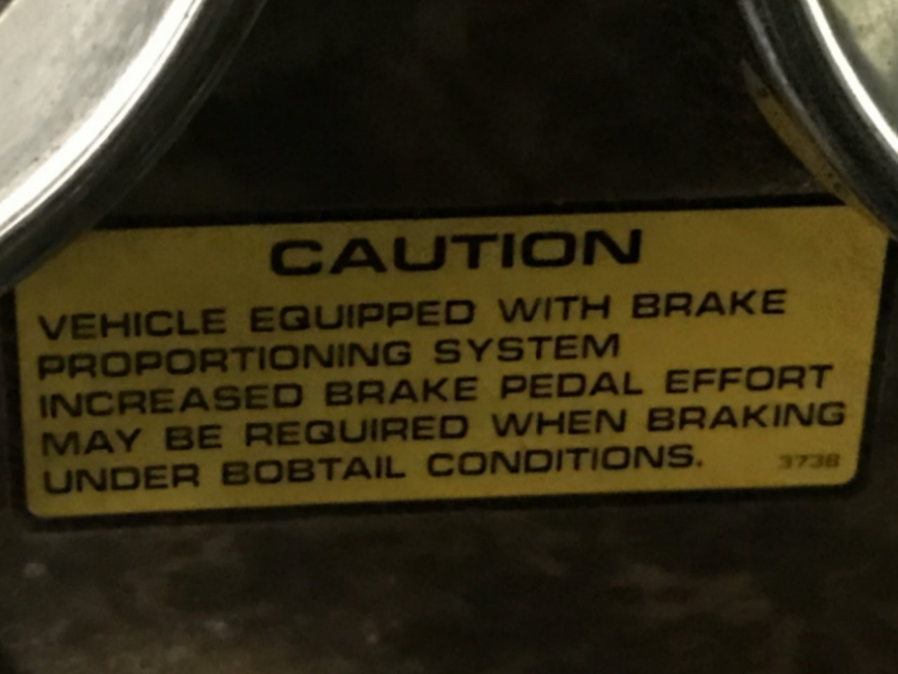

  4. OLDSKOOLERnWV
    19,084
    288,360
    This is on the dash of my Kenworth truck in my avatar. 1995 model.

  9. OLDSKOOLERnWV
    19,084
    288,360
    Decal says it all.

  10. SAR
    SAR Road Train Member
    2,756
    36,654
    Nov 26, 2011
    ND
    I've got that same decal in my 93 KW t-600.
