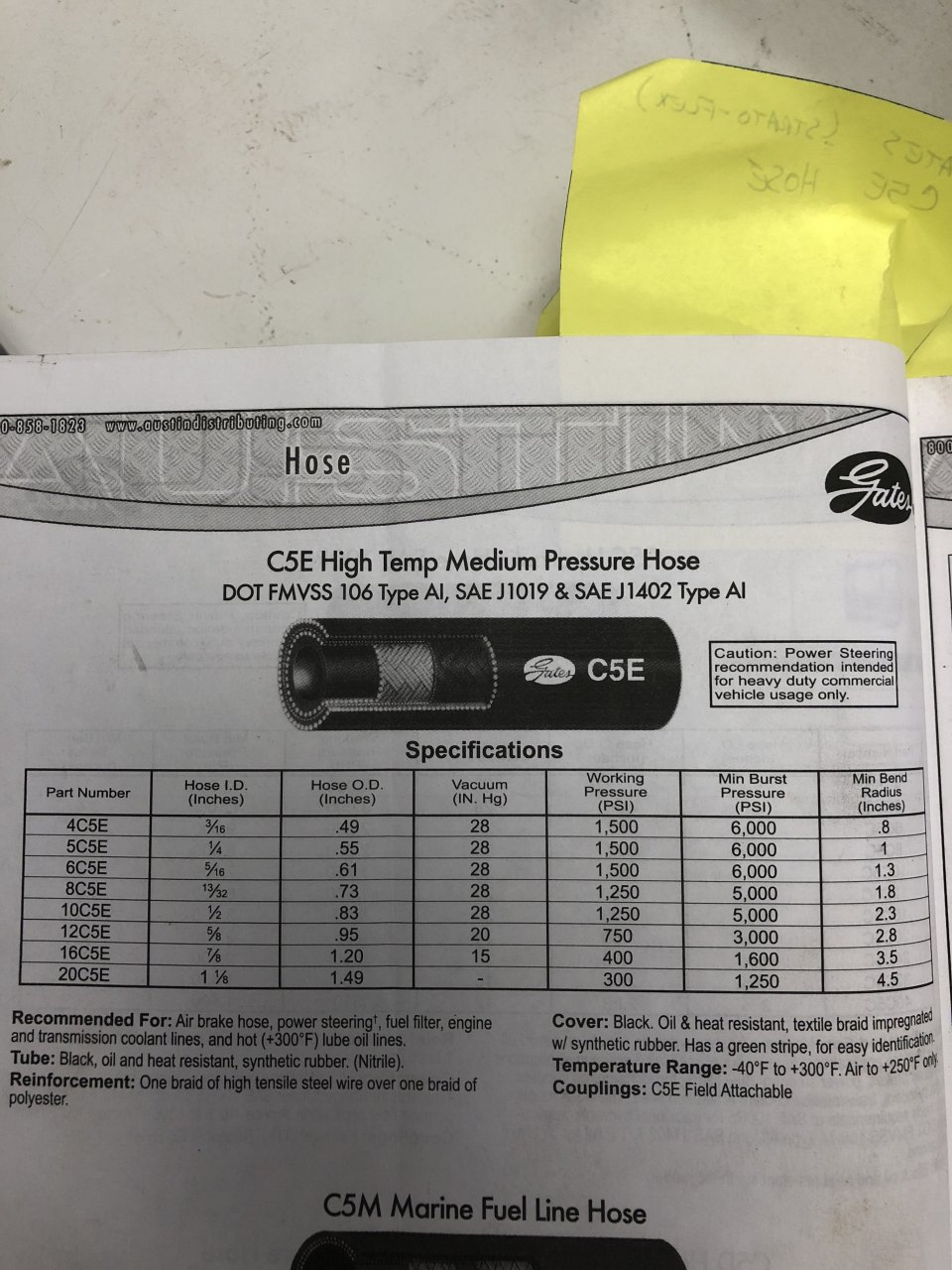

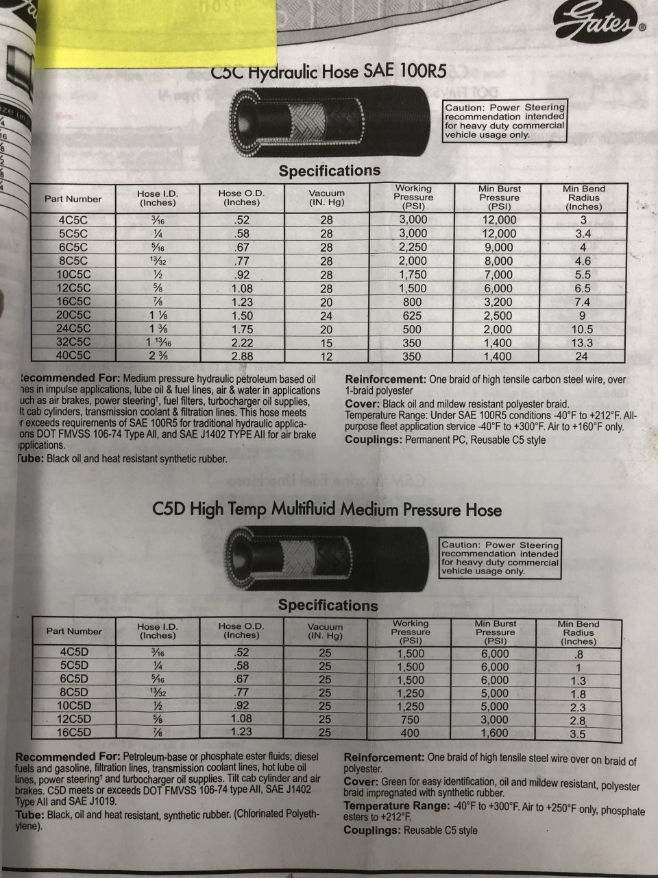

    Is it Gates C5C,C5D,or C5E?
    Aeroquip/Stratoflex and weatherbead devoloped it in the 30’s for aircraft and it became availiable to public after WW2. That hose was the industry standard from the 1940’s thru the early’80’s for everything on the older trucks. Used for air and all the liquids. Gates makes the exact aeroquip replacement sizes and hose ends. Parker has there own spec that has a hard time interchanging with the older weatherhead fittings.

    image.jpg 1550AEC3-B6B0-4707-A1BF-0F44C58A27CC.jpeg From the Gates book. Meets and exceeds all Dot/FMVSS criteria. All perfectly acceptable and legal.

    The stratoflex type steel braid hose was used on steer axle brakes and the hoses to the cans on the rears for 40 years before the manufacturers started to cheap out with the nylon and non steel cord rubber hose. So bending and flexing is not a problem. We kept having problems with the rubber hoses on the steer brakes kinking and breaking at hoseends on our ‘99 and ‘03 FL’s. So what did Frieghtliner do? They replaced them with stratoflex hose under warranty. Never had another problem. Everytime after that whenever we would take it back in to them for leaks or bad nylon hoses that get brittle in our heat and humidity they'd replace with stratoflex. Proving that the “ancient” technology is still superior for longitivtiy.
