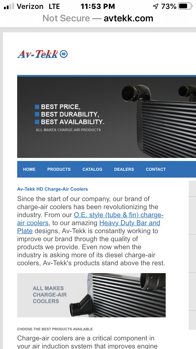

  10. Rideandrepair
    17,548
    56,852
    Aug 8, 2015
    79EC66DB-4E89-435F-AB4A-665D3815F821.png Buy a new one, about $750 for an Av-tekk. Bar and Plate. Don’t throw old away, take it to the scrap yard.
    ready2truck Thanks this.
