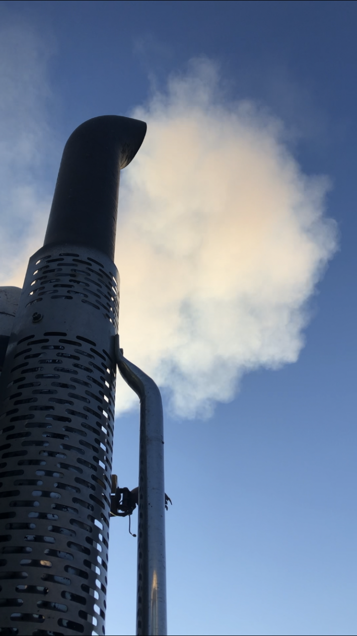

    Sounds like what I just went through. 6CD506AF-6A33-459F-BCE0-A110162E184F.png
    It was a bad wiring harness and bad wires for 2 sensors.
    The shop said some of the wires were contacting each other or bare metal and was making this Cat run bad, sometimes ok, miss a lot etc.
    We all thought it was bad injectors first, so I changed all 6. Didn’t fix it. Injector cut out didn’t find the problem either. No codes too until I finally forced the truck to throw a light long enough for the mechanic to get the code.
    5 volt reference, low voltage.
    Then Shop pulled the wiring harness that connects to the ECM and branches out to all the sensors.
    Every plug had bare wires right behind it. 2 sensors had bare wires behind the plug.
    So as the engine vibrated, the wires likely contact something and then the ECM goes nuts.
