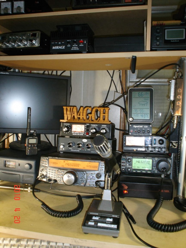

    Final comment ..... somethings apply on VHF no matter what your lissing to.
    I have built AM receivers below .25 UV but it takes lots of work and very low noise devices.
    The noisefloor of a receiver is first stage NF and bandwidth The low noise transistors ( under 1 db noise ) common if FM radios today were not around 40 years ago in the days of AM. Common NF on 2 in the 60's was as high as 10DB.
    I work in 2 way radio on UHF systems our work units run about .25 UV.
    My station here on 2 meters has a 20db gain .5dbNF gasfet preamp that takes it down on FM to under .1uv even less on SSB.
    I run a net on 144.210 sundays at 9pm Eastern time There is a very good FM net in grid square EL-87 at 8pm on 147.550
    If someone wants that weather radio to work right start likw we do on 2 meters with a good antenna.
