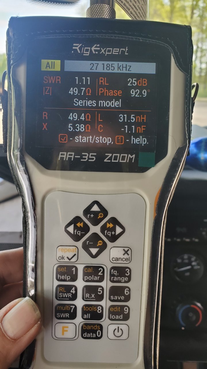

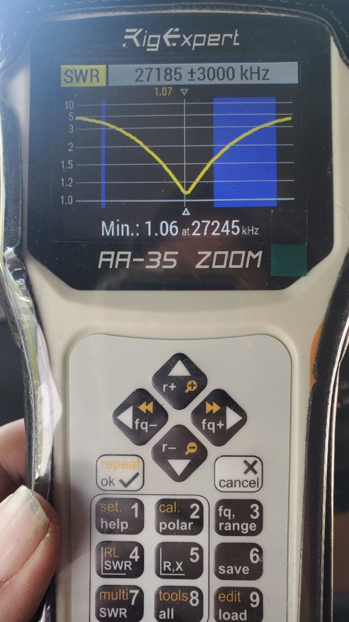

    Low SWR is not the full story regarding your antenna system! It's just a ballpark measurement that means you won't hurt your radio! BS you say?
    Readings from a stock hidden antenna on a Freightliner Evo.......
    Would any self respecting radio owner hook up a "big radio" like a Connex, etc. to a stock antenna? I hope not!
    The OP needs to get his antenna right first! A properly tuned Cobra 29 can sound plenty loud without a power mic! And a noise cancelling mic is almost a must in a big truck. The Road Devil is a decent idea, but they seem to have a switch problem lately.
    JMHO.
    JD

    Nobody said the SWR meter was wrong. There's more to setting up a good antenna system than SWR!
    On the antenna readings I posted above on an OEM Freightliner Evo built into the roof antenna, it looks plenty good! Everyone that has used one can probably say it's a if you can see them you can talk to them antenna!
    JD
