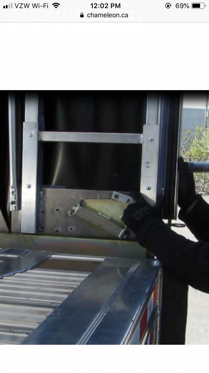

    Does your tensioner look like this?
    The bronze bracing bar with cutout for the tensioner nut shouldn’t be mounted far enough back that the rear of the unit can come past the rear of the trailer. That’s the part that’s mounted to the trailer, not the part that’s mounted to the sliding carbody carriage.

    I think I found what my problem was, I finally managed to get my hands on an installation guy. My issue is I have the rear tensioners as far back as I can get them, or as far back as I feel comfortable. The bracing bar is in a good spot but the slider and where the pin goes in hangs over the back of the trailer by about an inch to an inch and a half. I tried tensioning the bottom, because the top is loose and slaps around excessively. When you see pictures of this system all their trailers are nice and straight with no crease lines, my shows lines at the very top
