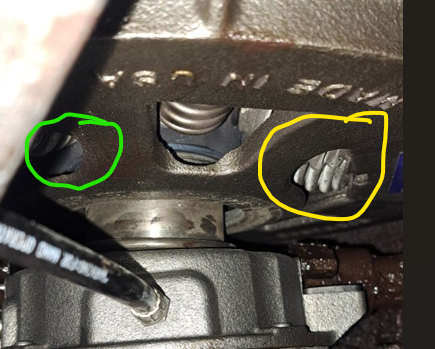

    Where does the grease come out at ? Keep pumping until you hear it popping or coming out from somewhere. Something about this just doesn’t look right.

    Thanks. It's not it doesn't look like they greased it.

    Notice the gaps circled in yellow. The one side of the fork is not even pressing against the bearing so the bearing is tilted (site did not like the work starting with coxxed) and not fully releasing the clutch. Possibly a broken fork or a severely worn bushing/bearing where the shaft attaches to the fork. What part of MD are you in?
    Does need to be greased but that won't cure this problem.

    Looks like this spring is broken.

    Thanks for the help and the info. It's in the Kenworth shop now.

    With 3k miles on that throw out bearing with no grease, it’s probably fried.
