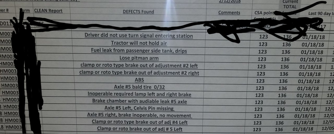

    Port truck going too far and got a nice beating by dot. My driver found it in the drivers room of the company 20180217_110438.jpg

    Only 2 oos? More than 20% of brakes failed and an air leak. Is the fuel leak oos also? Anything else?

    I thought the bald tire will put you out of service too

    To be fair, #4 and #5 axles are the trailer, unless he has more than 3 on the truck obviously, so the chassis prolly got hit hard as well. But then it's not too often they don't. Heh. What really cracks me up is the no turn signal violation.
