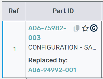

    As per the SAMCHAS, a baseline configuration is spec'd to the truck and here is the P/N you can order:

    Thanks, it looks like this is now the best option, and thing else we are just spinning our wheels and waisting time.
