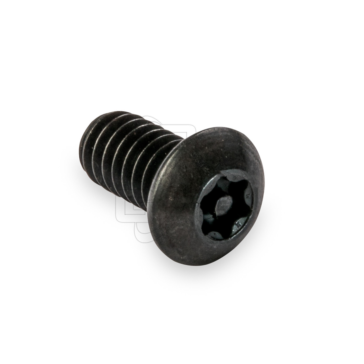

    If its that module behind the dash panel the easiest thing I can think of that might deter them or at least slow them down a little bit would be to swap out the screws in the dash with some tamper proof torx screws. Its not a common bit driver or screwdriver so I'd doubt many thieves would be carrying one. ST-81240-Tamper-Proof-Screw-01__88808.jpg

    Harbor freight sells them in a set with regular bits.
    A CPC isn’t your typical crackhead loot.

    True they're easy enough to get but realistically how many people wanting to commit a quick in & out theft are going to have one on them or are going to take the time to fumble with bits to find the right one?

    Finally changeing out the screws or say investing in some type of securment like a band to go over the CPC, ECM and physically secure it and further slow them is a good idea.
