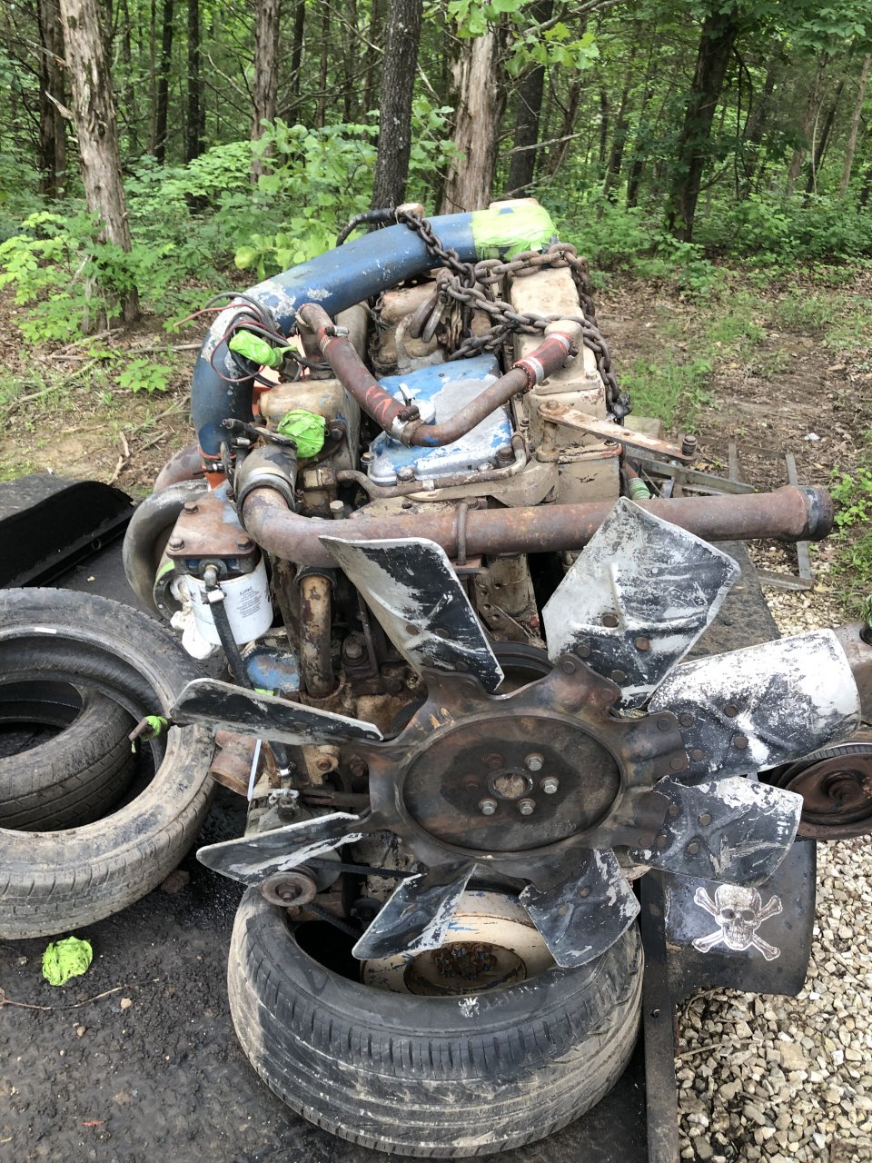

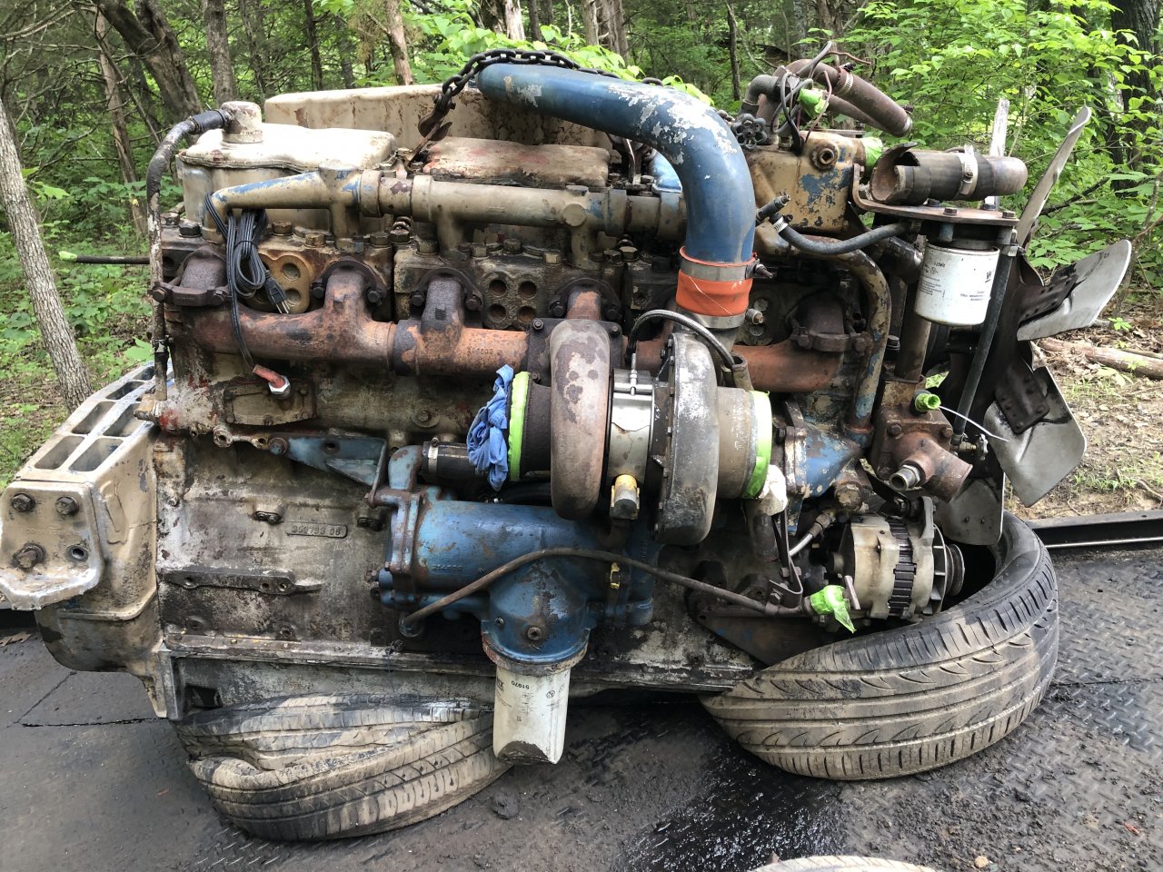

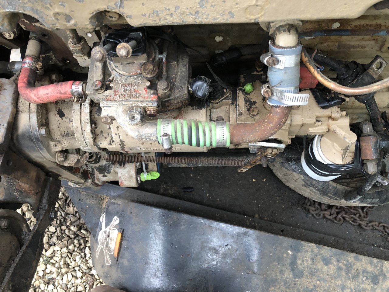

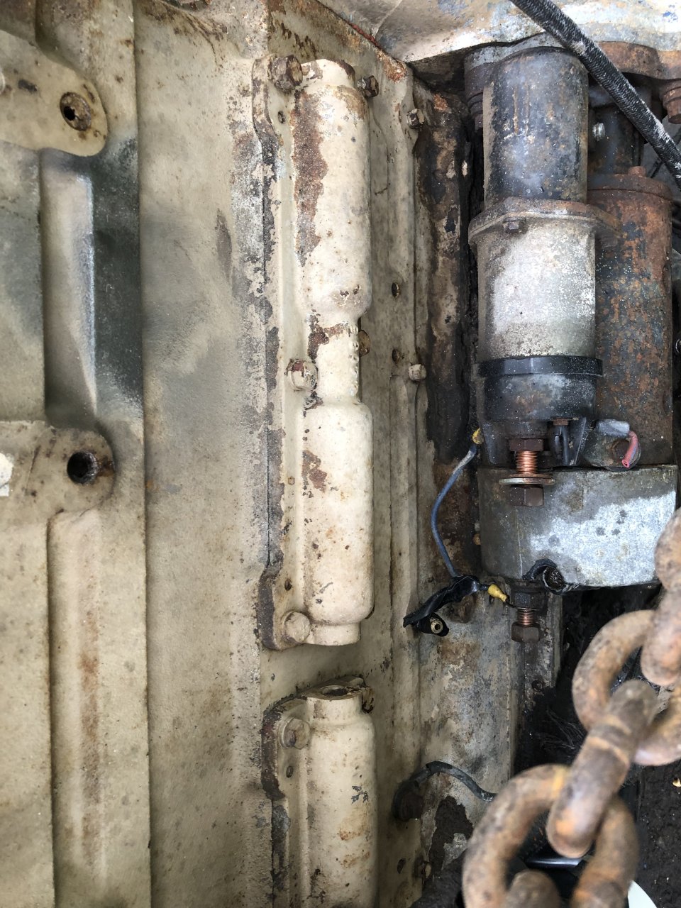

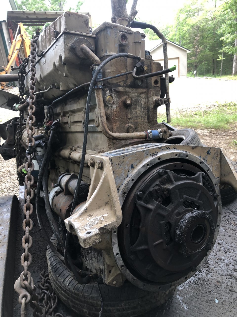

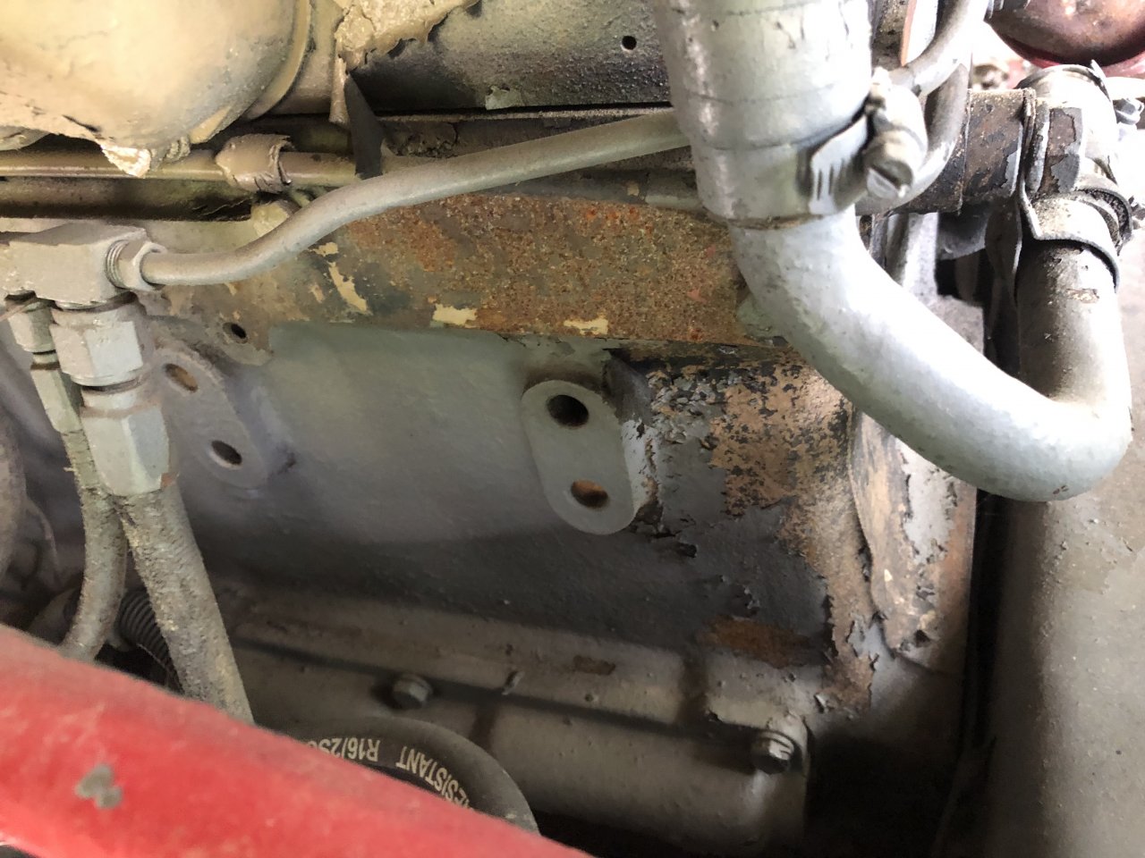

    I just bought this motor for $2000 running. I was told it was a big cam. It’s too late to do anything. I’ve got two small cams now I’m just gonna have to use them.

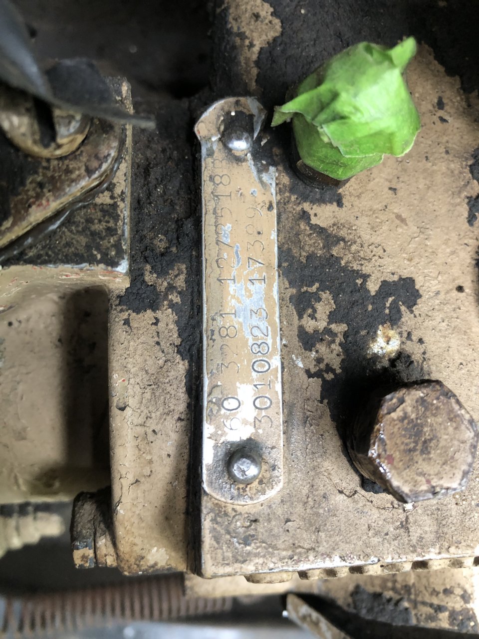

    Here are the pictures of the 1977 NTC 350 small cam
    Which includes pictures on top of the injector pump with tag

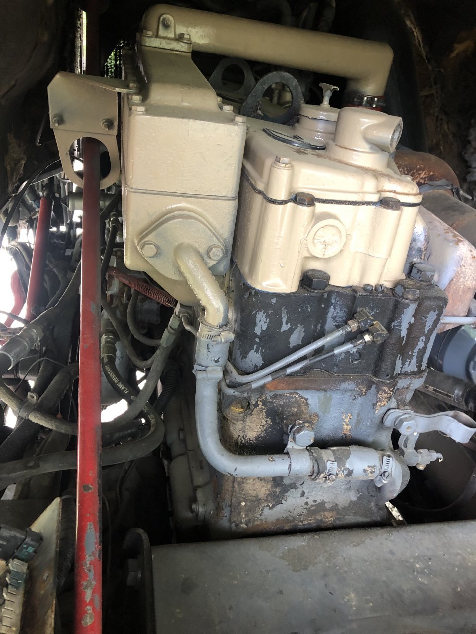

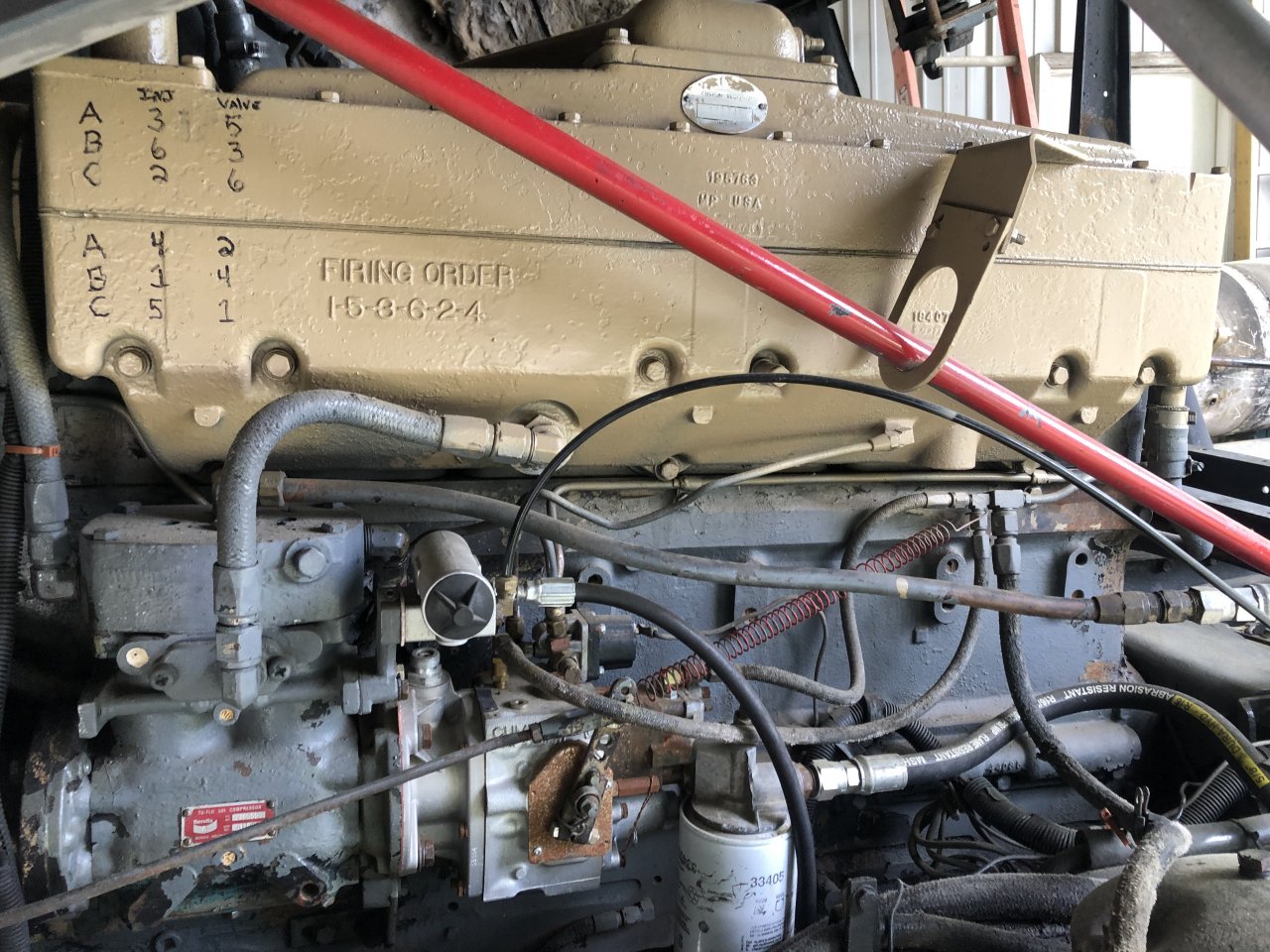

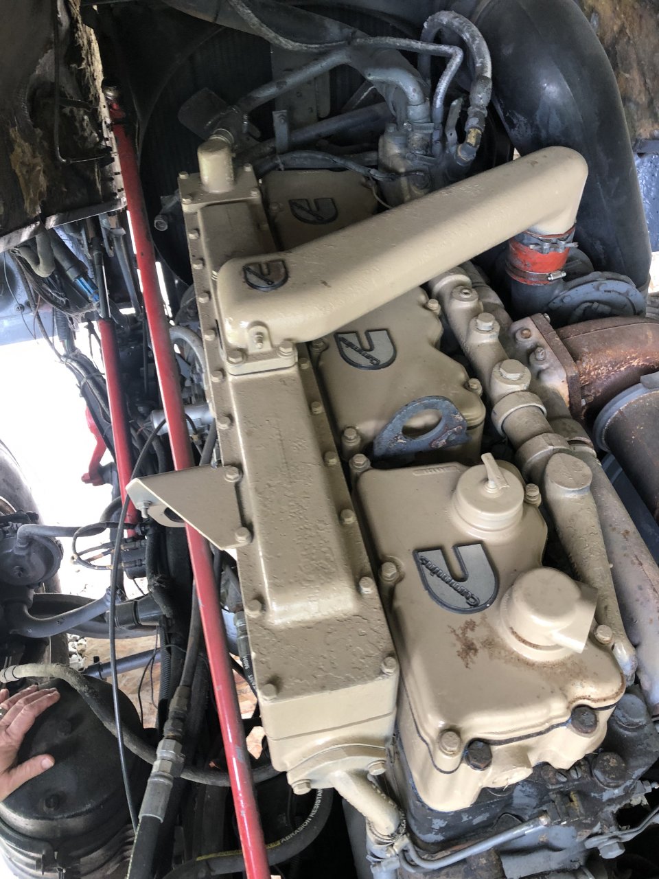

    And this next set of pics are the 1976 ntc350 small cam that’s in the truck with spun bearings IMG_4192.jpeg IMG_4190.jpeg IMG_4189.jpeg IMG_4188.jpeg IMG_4182.jpeg IMG_4183.jpeg

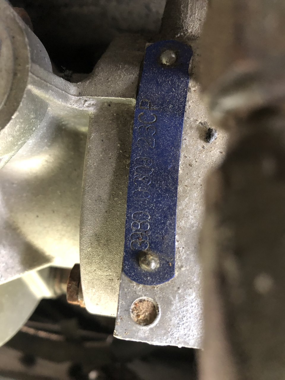

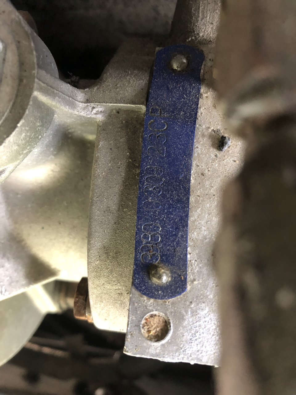

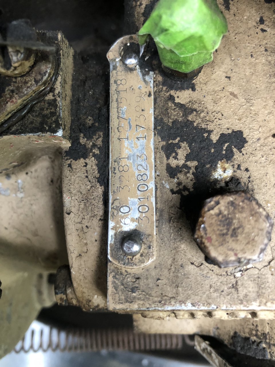

    Here are the tags on top of the fuel pumps
    The shiny tag is in the truck now with the spun bearings it’s a 76 small cam NTC 350,
    and the tag with paint on it is on the running motor. It is a 77 small cam NTC 350.
    If you can tell me if they are turned up or not and to what I would greatly appreciate it
  7. OLDSKOOLERnWV
    19,051
    287,645
    I’m waiting on a call back from a pump shop, I give him the pump number but he had to wait till the owner gets back to find the book…

  10. Binderdavemays1
    Binderdavemays1 Light Load Member
    169
    80
    Jul 30, 2024
    Luebbering Mo
    It appears that the turbo is in different positions from the motor that I just got to came out of the Ford and the motor that’s in the International which I don’t know what it came out of but the one that’s on the motor in the truck will not work on the one that’s on the motor I just bought
