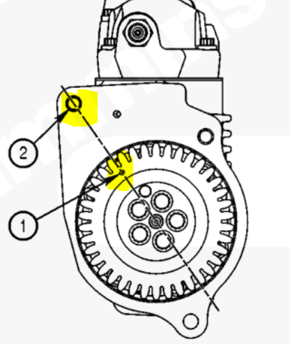

    Good job. Did you timed your fuel pump before installation? It's not late to fix. Engine crank should be barred to line marks and fuel pump should be in certain position then you can bolt it on. 4cbfb8ae-4acf-41a6-b4f6-11fe427103c2_Pump.PNG

    Hi thanks for the info I did have that in mind but when I took off the air compressor I had nothing to turn over the engine to set the pin since the 3/4 fitting is on the air compressor and I made the mistake of not doing this before the I took it off but what I do is place the old pump and the new one side by side and mark them both at the same spot so that the new one went in in the same position as the old one. Would this be okay or should I take it off and time it right?

  9. Snailexpress
    2,675
    6,069
    Apr 28, 2014
    Rocky
    You should time it properly otherwise it will be poor performance and destroying pump.
    Timing is for to have max commanded pressure(plunger up) at the injection time, not before or after.
    Depends of how far you off proper timing it will work long time or short time. Hopefully you got close.

    Thank you I will find the time to take it apart and do it right. Do you know if the air compressor needs to be timed also? The gear moved when it took it off
