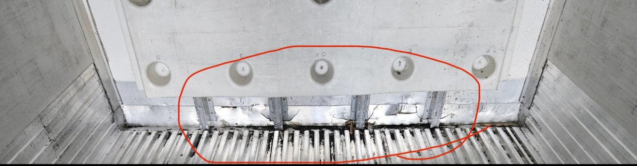

    Hi guys. I am very curious about prof views and I am grateful for that in advance.
    There are cracks caused by loaders on my reefer trailer. But i don’t know where this happened.there is no crack or bent at the otherside(outside) of the trailer and the cracks are only here. So how to fix it or how its gonna fix that? Is that cause me a problem if keep working like that?please some help. IMG_3261.jpeg

    I'd rivet a 1/2" piece of stainless in there cut to fit

    It's probably just breaking the skin over the insulation. The whole point of those beams is to reinforce it, but hit it hard enough with a pallet under the plastic and it'll compress the insulation when it flexes.

    Can i cover it if i buy a piece of wood from home depot and put it there to protect it from future pallet impacts?

    Do not put wood anything on the inside walls of a reefer, that is not food grade.

    So what do you suggest I put there?

    brother @Big Road Skateboard suggested steel. I would use steel also probably if I was in this position. Definitely wouldn't use wood.

    Reasonably thick aluminum plate will be lighter than steel. It will cost more, but in a reefer, steel will rust eventually, even if it’s painted

    Just put a 3"X 1/4" aluminum. Cover the whole ting and you'll block the RA flow.

    The insulation is compromised, it has to be repair right, that means going to a shop the manufacturer recommends.
    also when you drop a load, inspect the trailer for damages, if there is, then have the receiver write it up and pay for the repairs.
