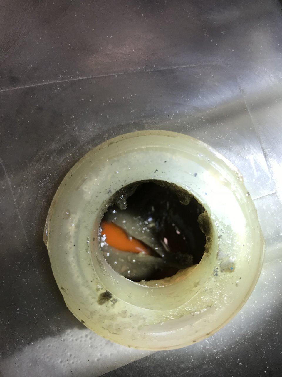

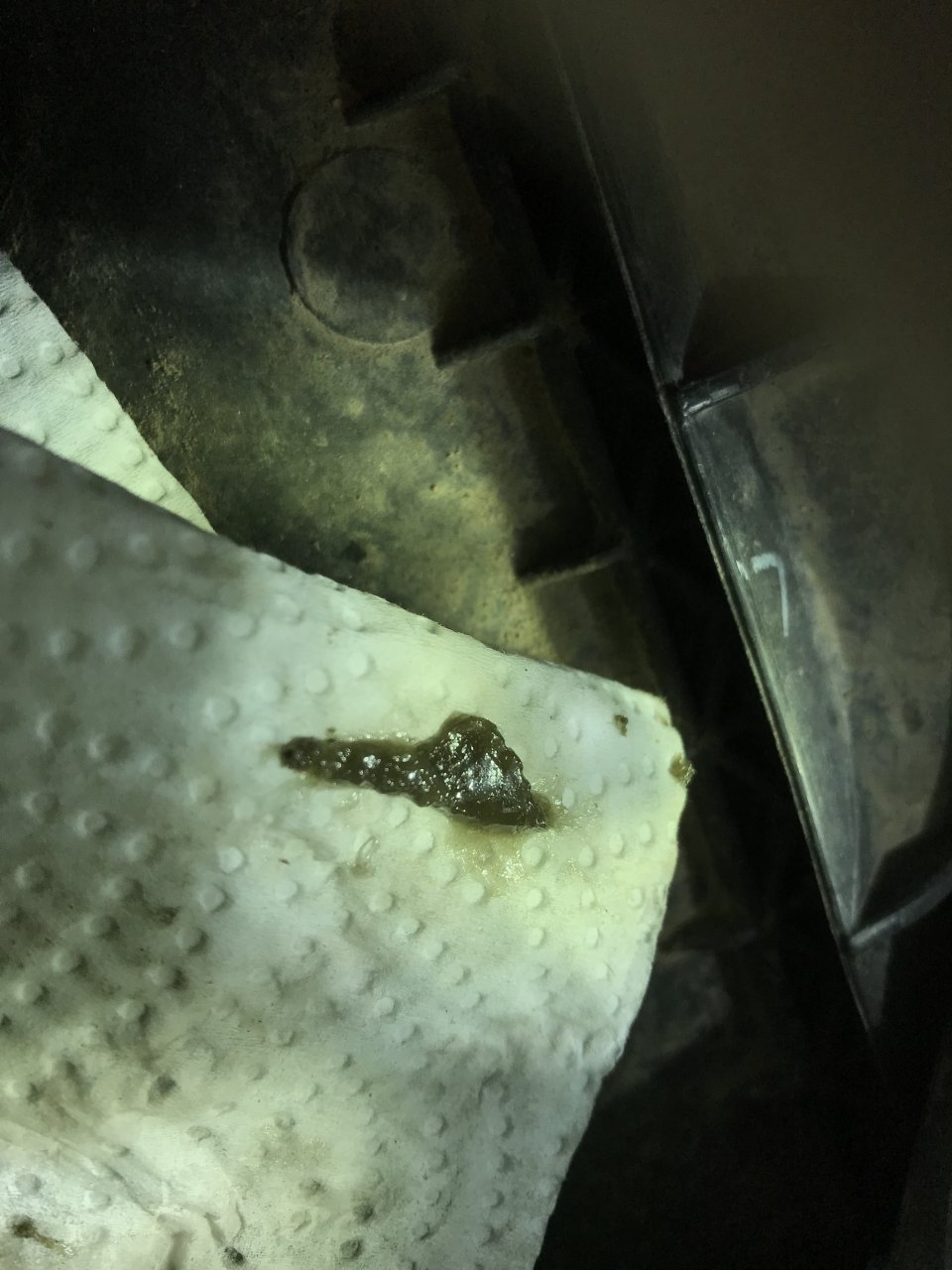

    E71C1E22-416A-499F-ACF9-338A21EB9F86.jpeg 5D025ECE-8792-4F35-8BE4-EDC2B1509293.jpeg Looks like I’ll need some injector work. Discovered fuel in my radiator surge tank.

    how many miles you have now? this problem usually starts after 500k miles

    290,000 km ( 181,000 miles). 2016 Cascadia.
    Noticed a bit of stuff in coolant last weekend but couldn't identify what if was. Kind of gummy.
    But this weekend there is a whole bunch, and now it smells like diesel.
    I do have extended warrranty.

    post this issue on DTNA Solution. I guess DTNA has found cheap supplier of this O-rings. Extended warranty is good but downtime is expensive too. Let DTNA engineers/designers and fat ### bosses see this.

    find a time and replace them. if they start leaking you will pay 2x more.

    Truck is getting fuel injector seals replaced this coming week. Will throw in injector cups at the same time.

    smart decision.
