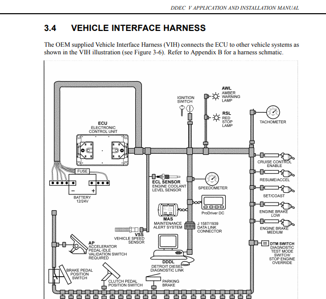

    seasons greetings I have a fld120 glider that was wired for a ddec iv 12.7 but I have a ddec v 14L that I would like to drop in so I can get the truck back on the road. What is needed to be done in order to make the swap work.

    As far as I know DDEC-V still had just the engine ECU, DDEC-VI used MCM and CPC.
    I'm pretty sure DDEC-V uses different connectors and terminals than DDEC-IV, so you will have to rewire the vehicle wiring to the ECU, or find a suitable vehicle interface wiring harness that matches your truck and the DDEC-V ECU, if these exist at all.
    I have pdf Application and Installation manuals for both IV and V, I can mail them to you, so you can research and go from there. Send me PM with email address and I'll try to send both of them to you within next couple of days.
