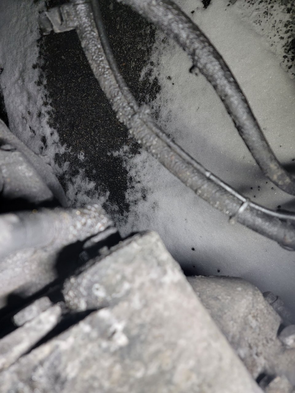

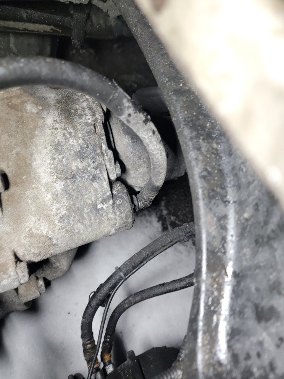

    Picture of where your air line connects to the front diif? Some have an air cylinder that unscrews and you just screw in a new one.
    Is what it looks like if the ground wasn't snow covered I would try and get a better picture

    Hard to tell from your picture but I am guessing that is in the Eaton 380 - 402 series. Believe those have two bolts, one on each side of the air line, which allow the air cylinder to be removed. Piston can removed from shift fork. If the hard parts are good you can just replace the o -ring.

    By the year and picture looks like you have the typical DSP40, what that air line screws into is a plastic cap that you can unscrew out of the housing, under that is a plunger, both have o-ring seals on them, replace those 2 o-rings and that should take care of the leaks as long as the cover and plunger aren't cracked.
