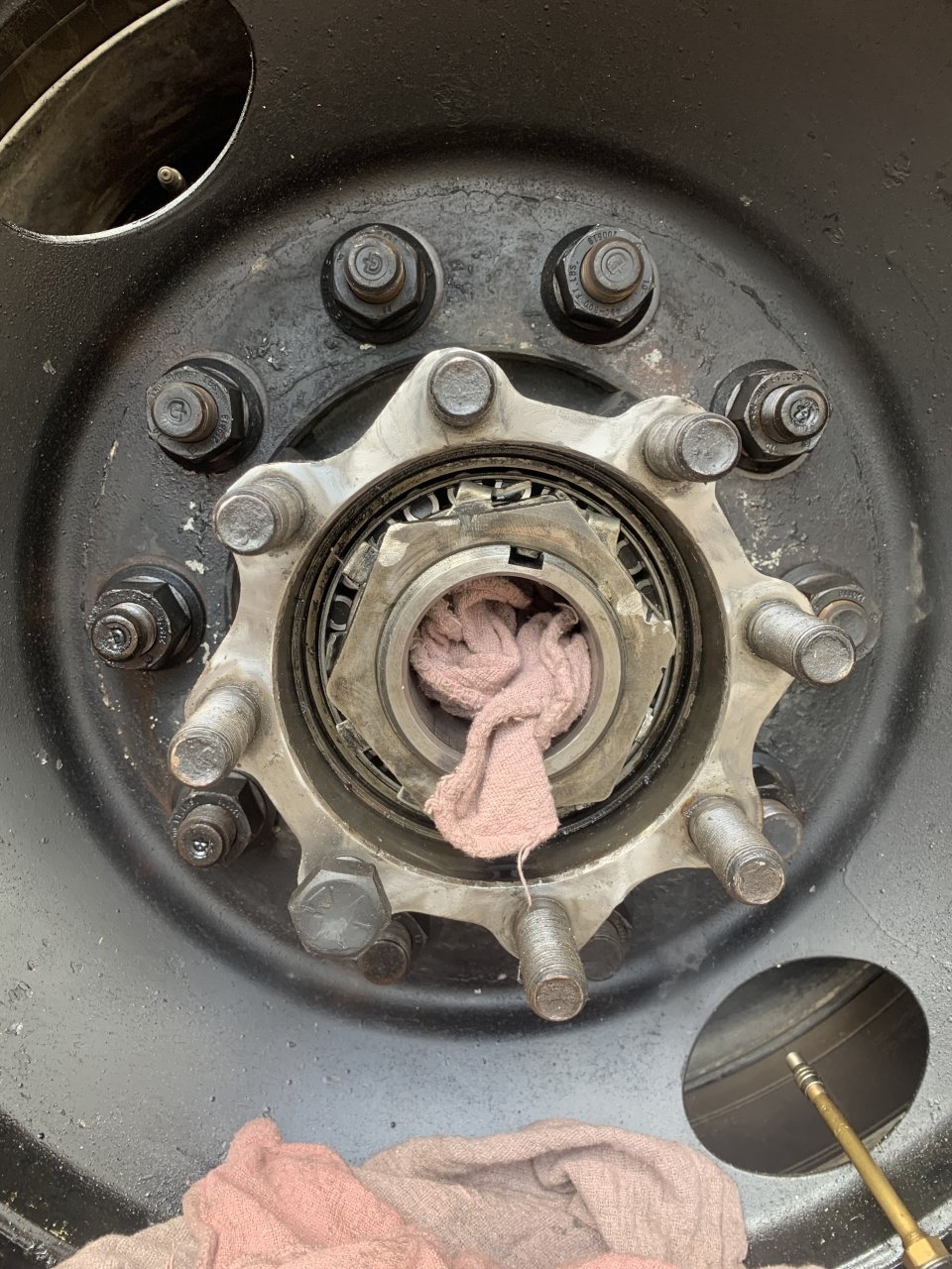

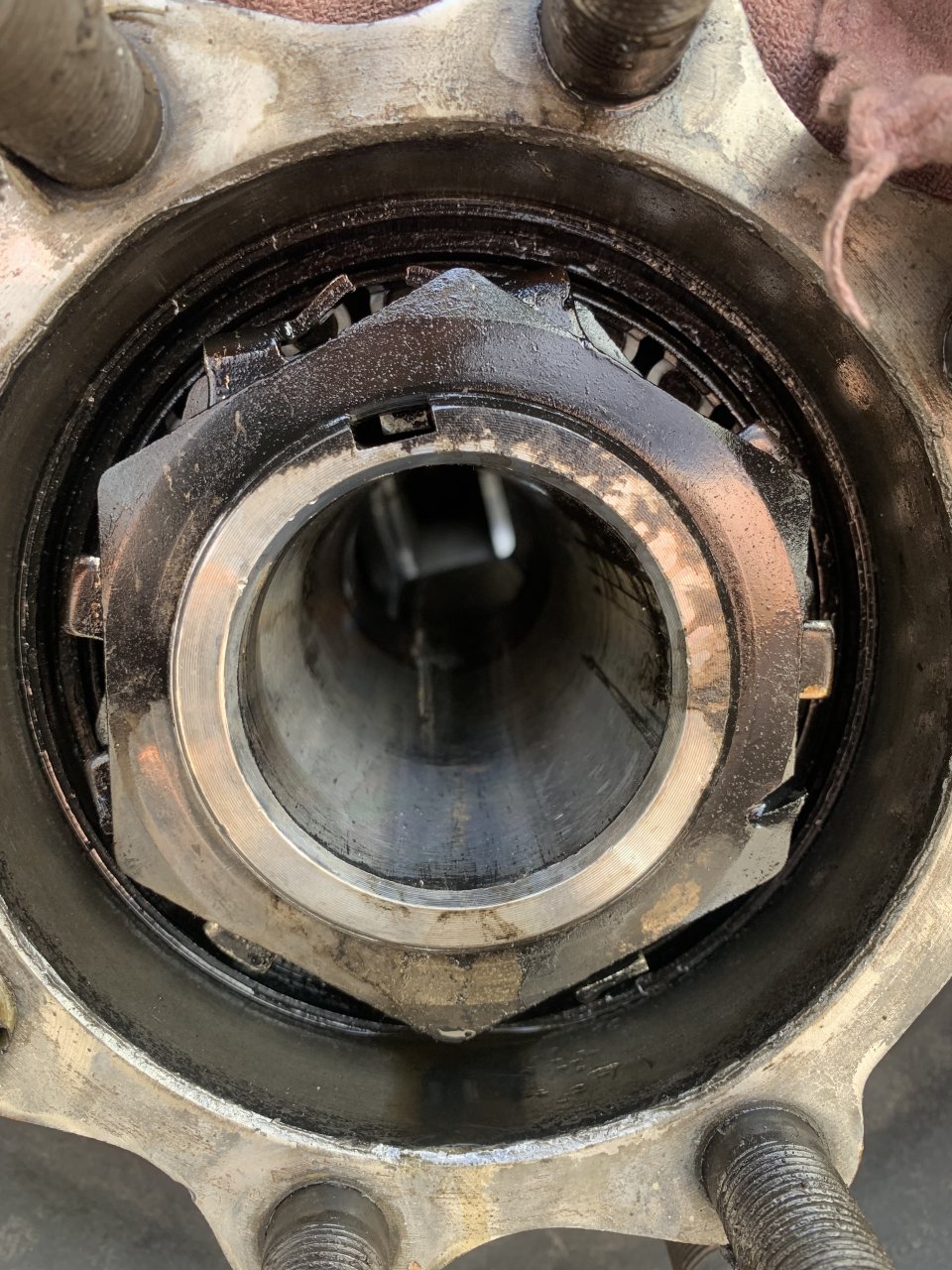

    Took my truck in to find pinion seal that blew out but had a lot of big chunks in my housing once we took it apart to see because the yoke had so much play,. Ordered a reman to be put in. Also have drive shaft got work done
    shop is advising to take apart wheel bearings, races, and change out wheel seel on both sides, or don’t have them clean out the banjo housing and out new fluids and go
    My think is right now my bill is gonna be around 4800, if I do the wheel seals, bearings, and races on the axel that jumps it to 7600..? Does it all need to be taken apart?

    Are they on coke? $2800 to do wheel bearings/seals on one axle? That should be like a 2 hour job MAX per wheel end plus parts. I mean the axle shafts are already out. They may not even have to do the bearings, if they aren't damaged or pitted I'd just clean everything, put a new seal in and put it back together.
    That said, 100% yes get it done. Very likely the debris floating around in the diff made its way out to the wheel ends. Doesn't hurt to make sure they're good.
