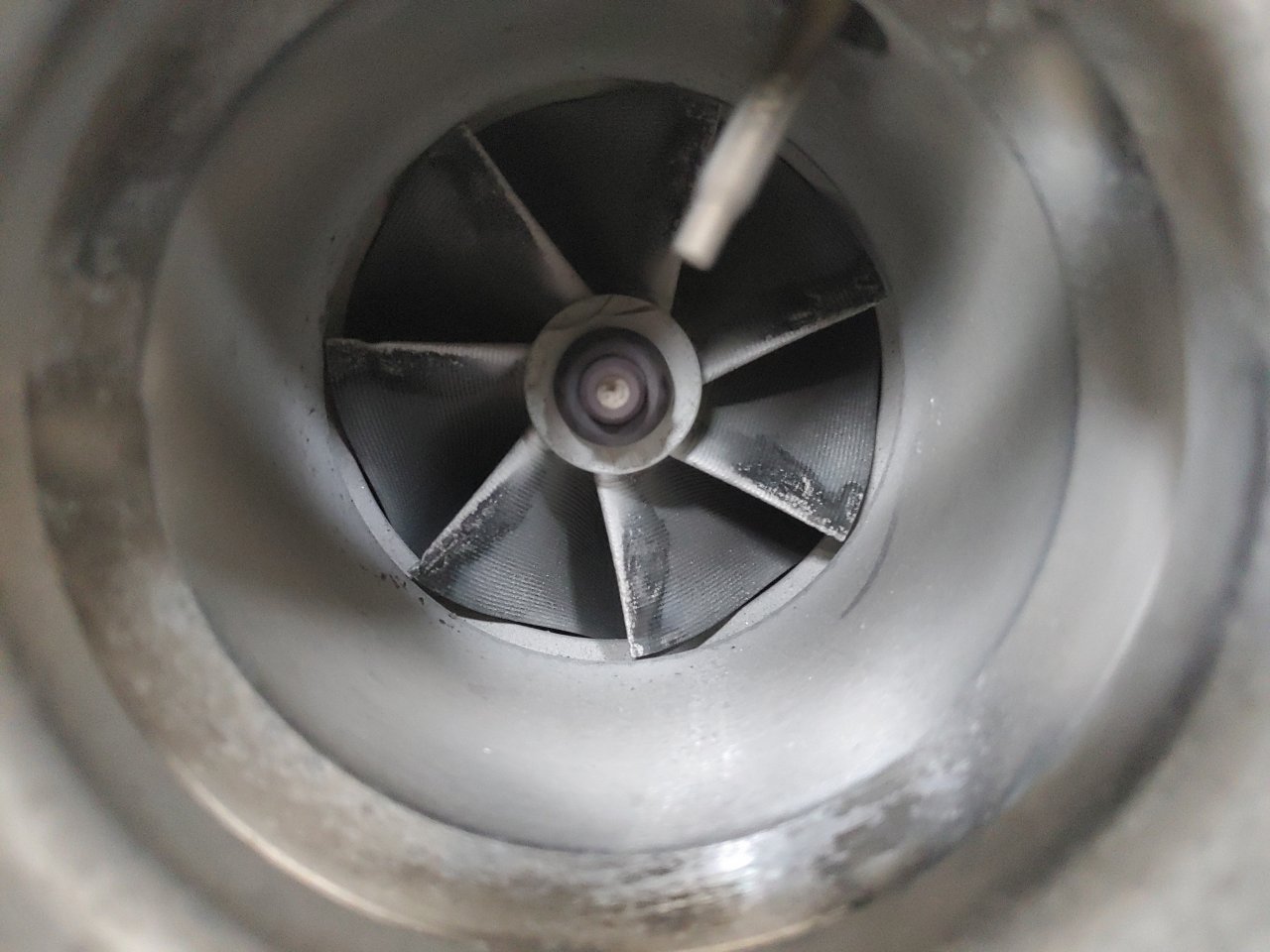

    I bought this truck a few weeks ago and right away I noticed under a loaded trailer that there is a real lack of power in the top gears.
    Engine runs great. Doesn't use oil, no noticeable blowby, coolant stays level, starts good, idles smooth. Turbo gets up to about 38psi wide open.
    Everything seems perfect except when I hit a hill or even when Im on fairly flat highway and try to get to highway speed (62mph)...it falls on its face in 16th to 18th gears.
    HOWEVER...about a week after I bought it...I noticed that the wrong air filters had been installed and air had been getting past them.
    I got a sick feeling in my stomach and pulled the filters. There was a little dust in the intake tubes. Took a look at the turbo and there was a couple very small nicks and not as sharp edged as new. But it still produces 38 pounds at full throttle.
    So, I'm wondering if the turbo could be the cause of the low power at top end? Or maybe I'm just not used to driving trucks with emissions still intact and it's normal to fight the hills...but I doubt it.

    I'm attaching a picture of my turbo fins for reference. No play in the turbo side to side. No play in/out.
    Any ideas or help is greatly appreciated.

  7. AModelCat
    29,669
    164,493
    That turbo has definitely seen some dust. I don't know Cummins' reuse criteria but it looks a little on the rough side.
    Brettj3876 Thanks this.
  8. Rubber duck kw
    Rubber duck kw Road Train Member
    6,092
    17,686
    Dec 9, 2017
    That turbo looks like it's had a hard life to me.
  9. skman
    skman Medium Load Member
    313
    133
    Aug 26, 2013
    Saskatchewan
    Do you think that could be the cause of low power? It seems to be making full boost and holding it.
    I'm getting no codes for anything so I'm kinda at a loss of where to look.
    Started on cheap stuff with fuel and air filters. Cleaned some sensors (might still change IMAP sensor because it looks original and it's not too expensive.
    Turbo and fuel pump were my next guesses.
    I am considering removing emissions. That would rule out the DPF being clogged at least.
