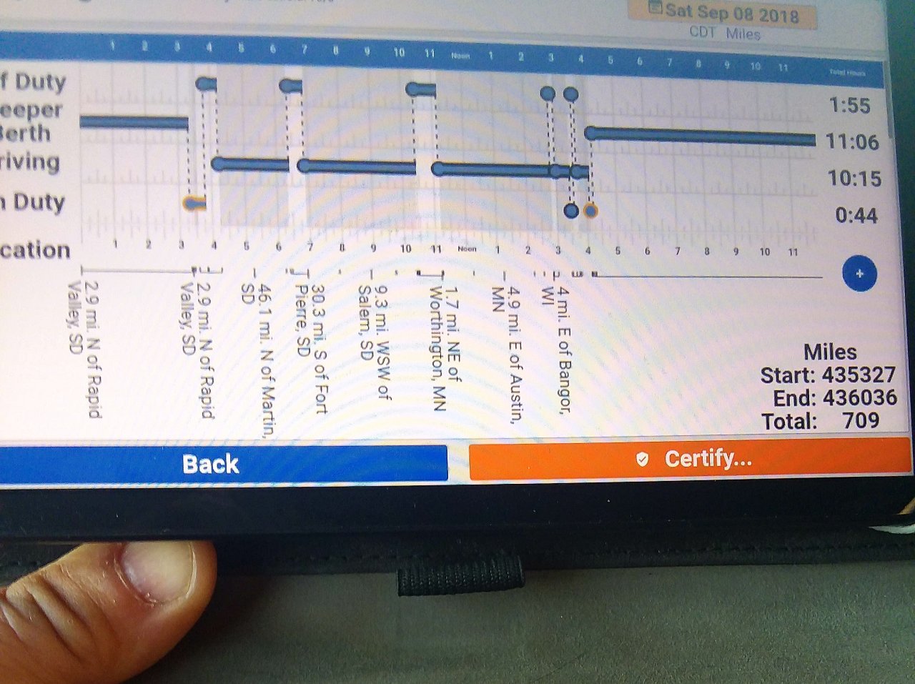

    On the other hand, I wish I knew what change in mpg would be If I slowed down. Anyone experimented on that? Even if it is 1 mpg as a result, the money saved is not something to snub at. 100K miles at 6.5 mpg renders 15.385 galons. That's about my avg per year. 65-70 mph range. So If I slowed down to 55 mph...I consider going slower as not safe, then what would my average be? 7.5 ?...13.333. 2051 gal saved * $3.25 = $6.668...actually not bad. I could not avg 55 mph - too much of a torture!
    The question remains: Is it really going to be at least 1 mpg by slowing down 5-10 mph?
