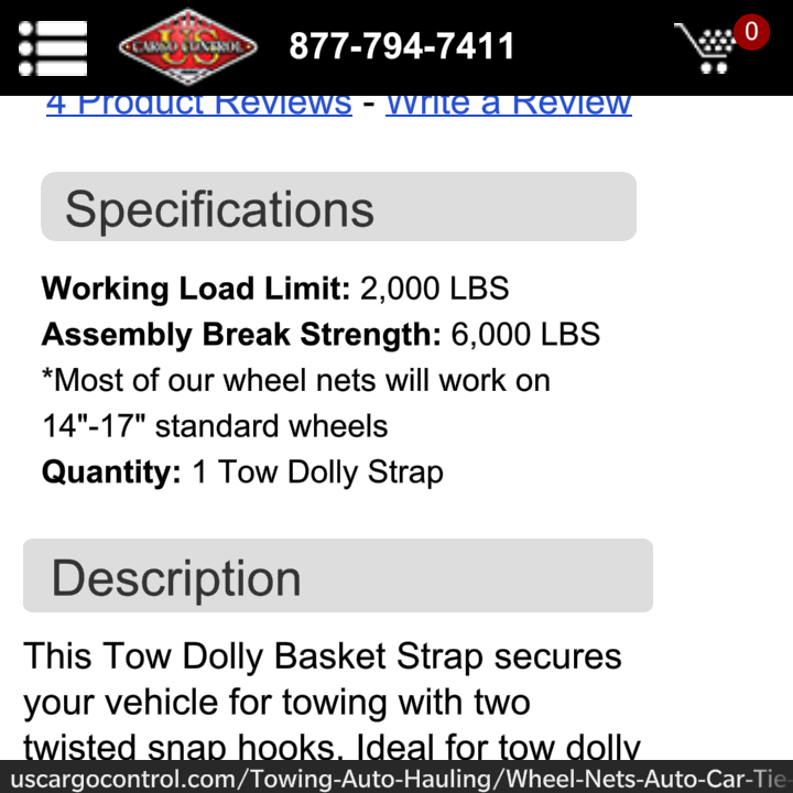

    6000 break strength X 4 = 24,000# of restraint.
    3000 pounds @ 60 mph = nearly 110,000# of force.
    Not even close. Even if you went with the flat hooks instead of the snap hooks and doubled the break strength, you'd STILL be at less than half of what you'd need to hold back the load. IMG_20160724_232133.png IMG_20160724_232152.png

    Those are some crappy straps, a good BA Products wheel strap will have a WLL between 5,400 and 6,600 pounds with a minimum safety factor if 4:1, so the ultimate failure load would be 21,600 to 26,400 per strap. Hammer has it right below, the strap and hook is not the weak link the decking is.
