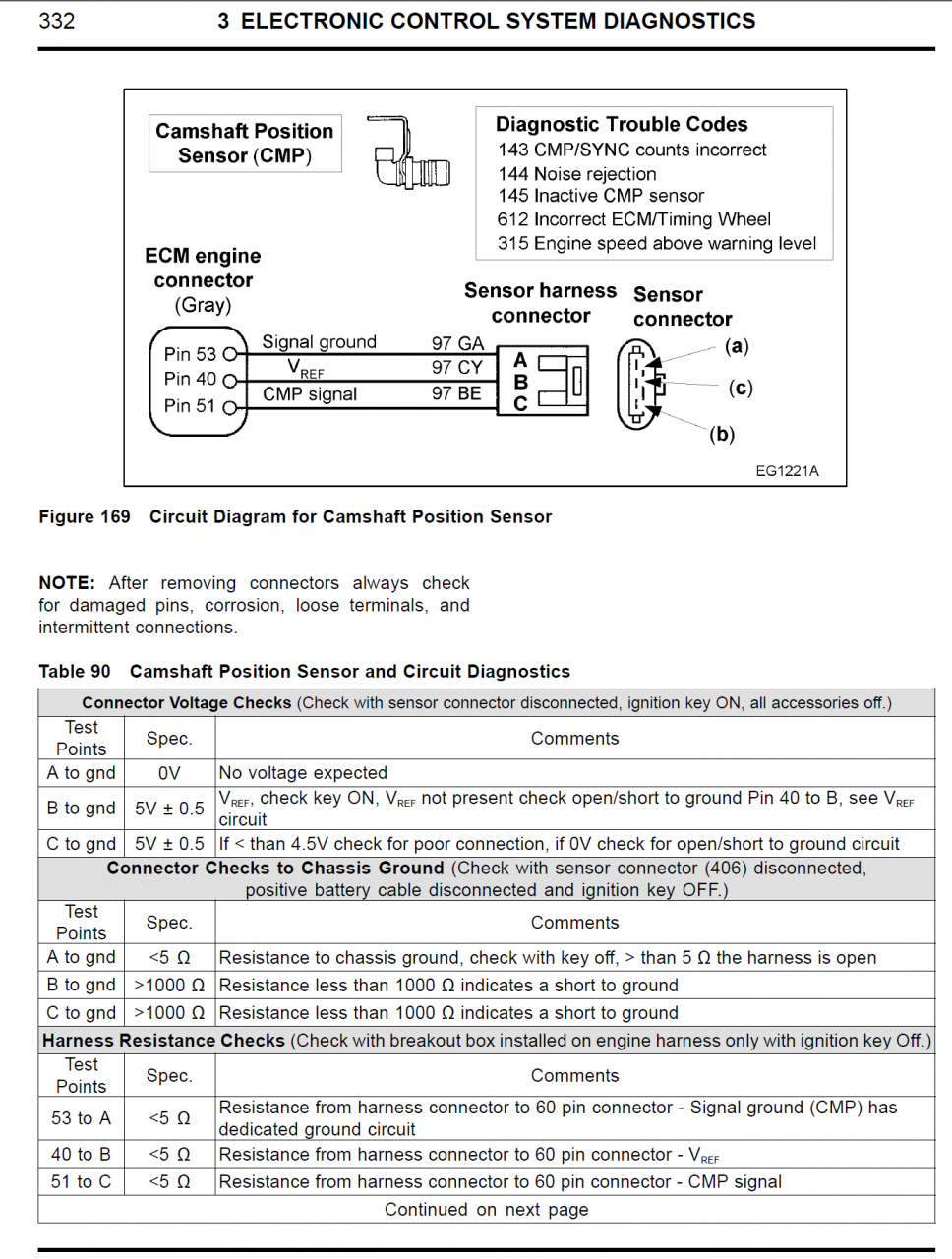

    Two things that are concerning to me: 1) fuel pressure is good (50+psi) but the needle is bouncing all the time and doesn't ever stabilize. Air in the line somehow? Tried diagnosing it but not finding a source or leak anywhere. 2) CMP pigtail shows neutral [wire 1 in pic], 5 volt [wire 2 in pic], and third wire which (I think) should show 12 volts only shows 4.9 volts [wire 3]. This is key on, engine off.

    Cam sensor.png Your cam sensor is a 5 volt sensor. I have attached some basic test point information for your engine. Remove the cam sensor connector and ECM Grey connector and check the pins for being damaged, pulled back or spread to wide. This will make poor contact and cause signal problems. Then you need to check the continuity of each wire between the cam sensor and ECM. Perform wiggle tests on each wire while measuring resistance with a meter to see if the wires are good. You already mentioned your 5 volts is good. If that checks out, the air gap needs to be checked while cranking the engine to make sure the run-out is acceptable. To do that, you would need this tool, CMP SENSOR AIR GAP TOOL | International Or you can skip that, and hope for the best, and just install a new sensor. Sensor gap still needs to be in spec of 0.025 - 0.030". These sensors when they go bad, will normally run fine until the engine is getting up to temp, then they glitch out.
