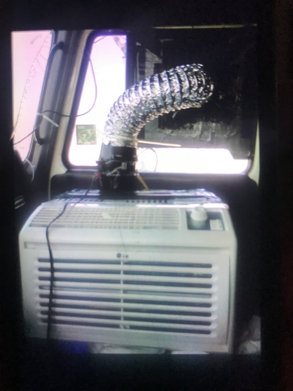

ductless wont work. i have tried both routes. if you go with portable. you need the 2 hose one. if you box in the back of a window unit. it get extremely hot.Intothesunset Thanks this.
this was my set up. had to peak and tune it several times but worked great. i used one of those idle aire window adpaters and 12v computer fans
6wheeler Thanks this. -

What is that contraption? Is that a window unit in the truck?
