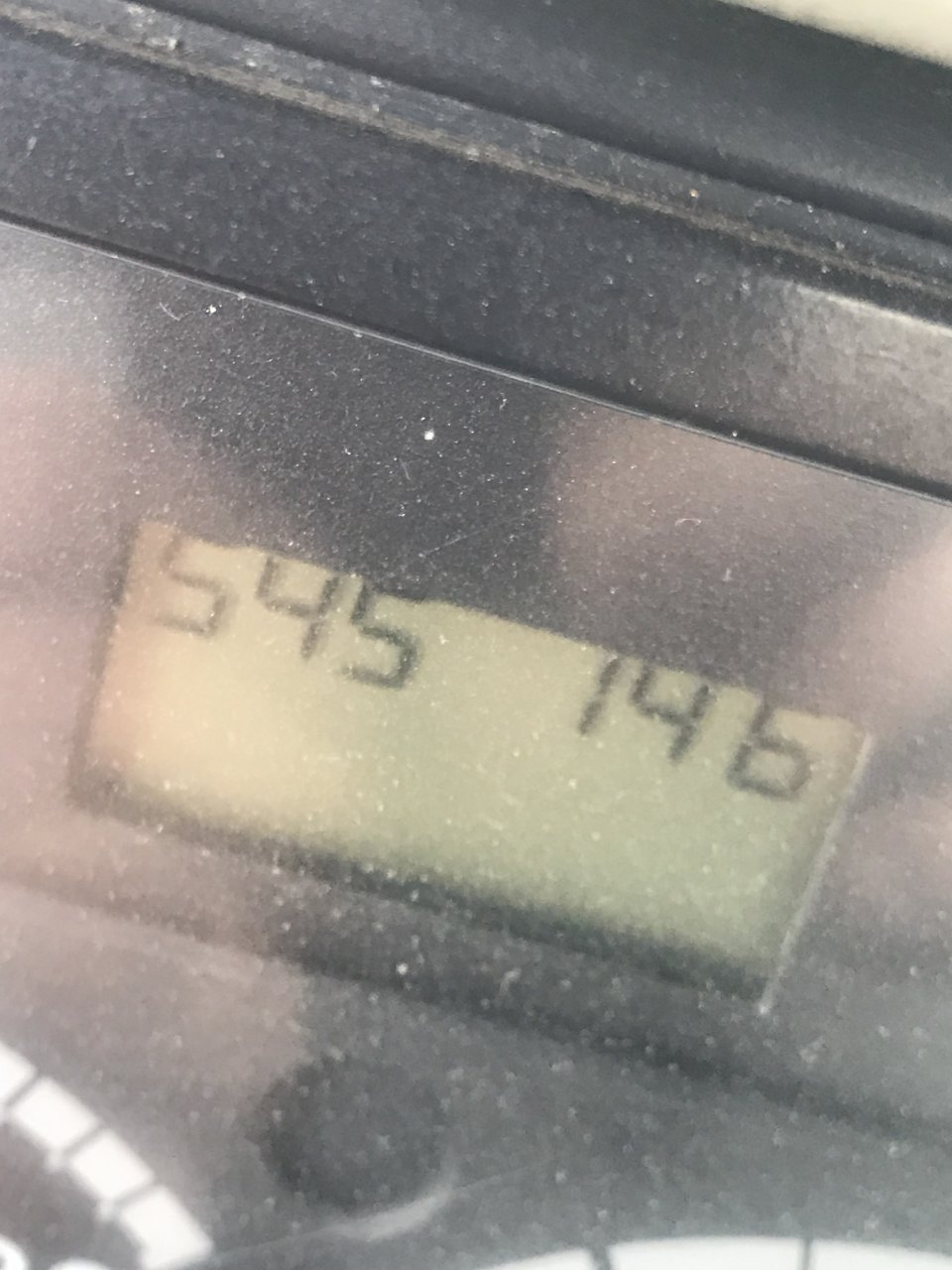

    51F18745-A785-4572-89FF-B5A204BE87BE.jpeg I have a ECU 128 followed bye a Pid 111 and above code. Can anyone help?

    The 128 -111 code is for coolant level data, need to know what the fmi number is. The other code I'dont know what it is. I know that 146 is for climate control..Check your coolant level, if it's ok you have and issue with the sensor or the wiring..
