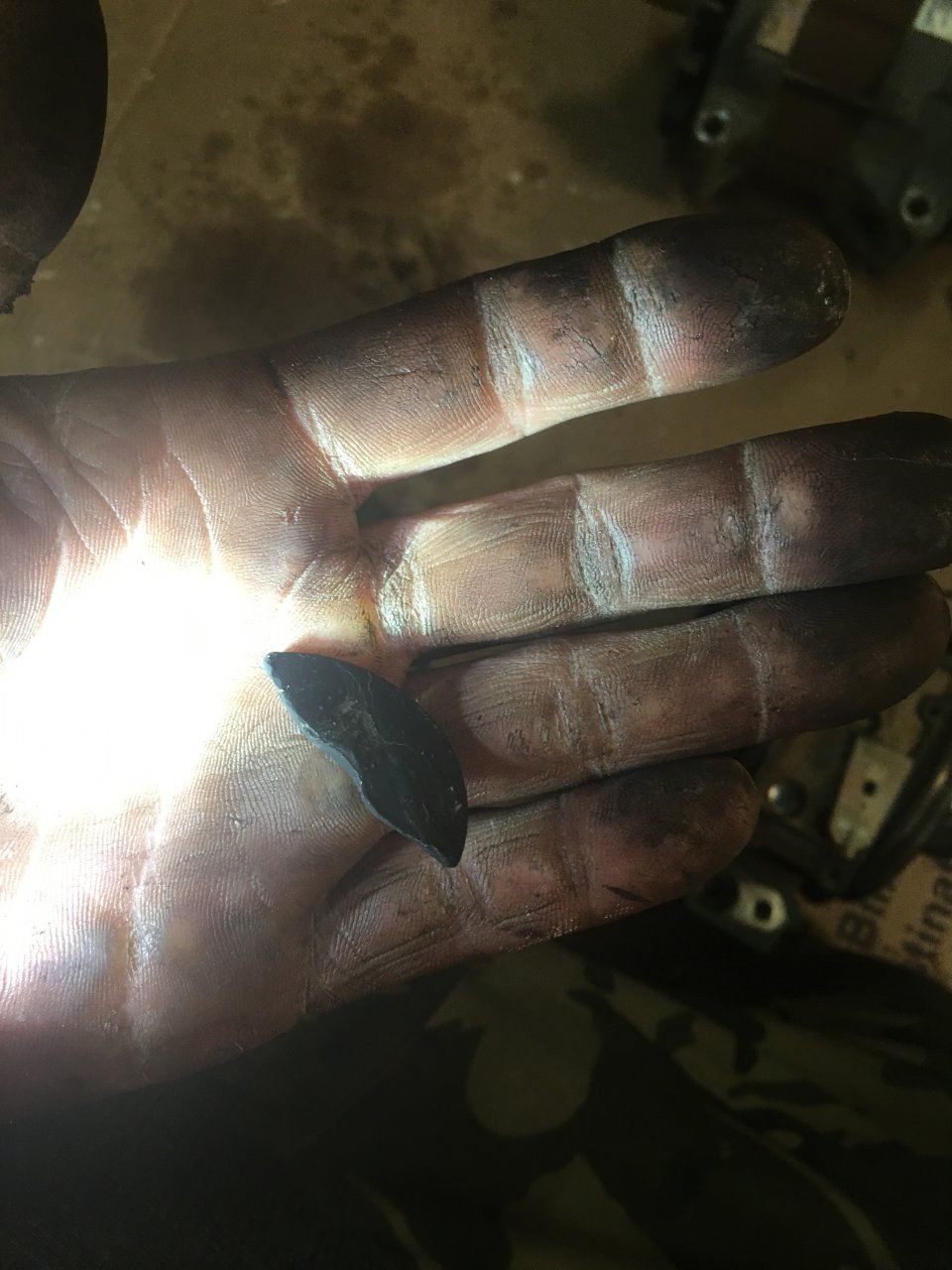

  8. mobilerepairboise
    mobilerepairboise Light Load Member
    Joined:
    Jul 10, 2018
    Messages:
    61
    Thanks Received:
    42
    Location:
    Boise Idaho
    Newto Trucking and Jack carg Thank this.
