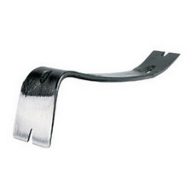

That's the method I used.
I plan to put everything back to together with duct tape. -
