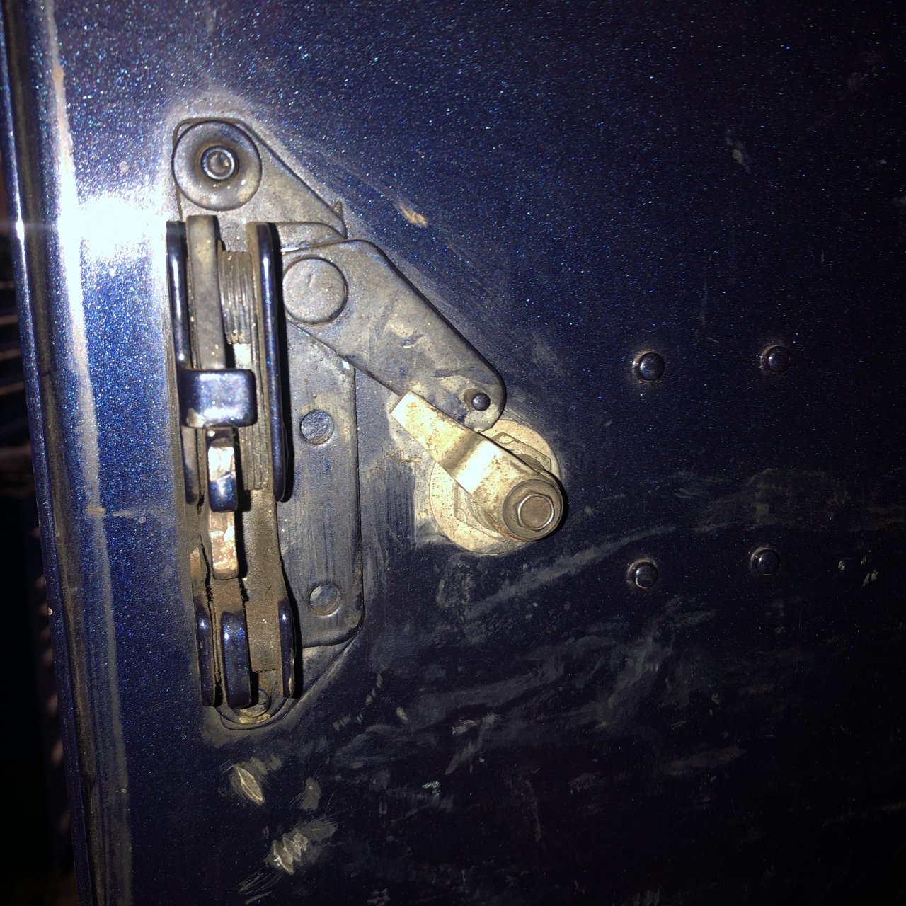

    I was not given the keys for my sleeper doors on my truck.
    I did drill the lock out but I got carried away I guess and I ended up drilling the whole entire everything out. I did not damage the door and everything came out but the door is still locked.
    I can't get behind the door to see what the latch looks like. If I take the mattress out and the piece that's underneath of it can I get down to the doors that way?
    If so, how difficult is it to get that out and get to the doors?

    Ignition key opens bunk door.
    Yes lift mattress. Full access and more storage space.
    Your mattress shelf hinges off back wall. The rod you see about middle of front support is the latch.

    You drilled the door latch out. You have a hole in the door.
    Put your left pinkie in the hole finger end towards rear.
    You will feel a piece of metal. That needs to be pushed up with your finger.
    Moves easier if you push in the door with otherhand.

    They must have changed the locks somewhere along the line because the ignition key won't open mine.
    Thank you for letting me know about that latch. When I get down to the garage tomorrow I'll see how that works out.

    My under bunk door is different then my ignition key. You didn't need to drill a hole through it. You could have just raised the bed and taken it apart or opened it from the inside

    I did not drill a hole in it. I drilled out the lock.
    I have new locks to put in because my key doesn't work them.
    I probably will take the bunk out and go down and open them that way and I can put the new locks in.
