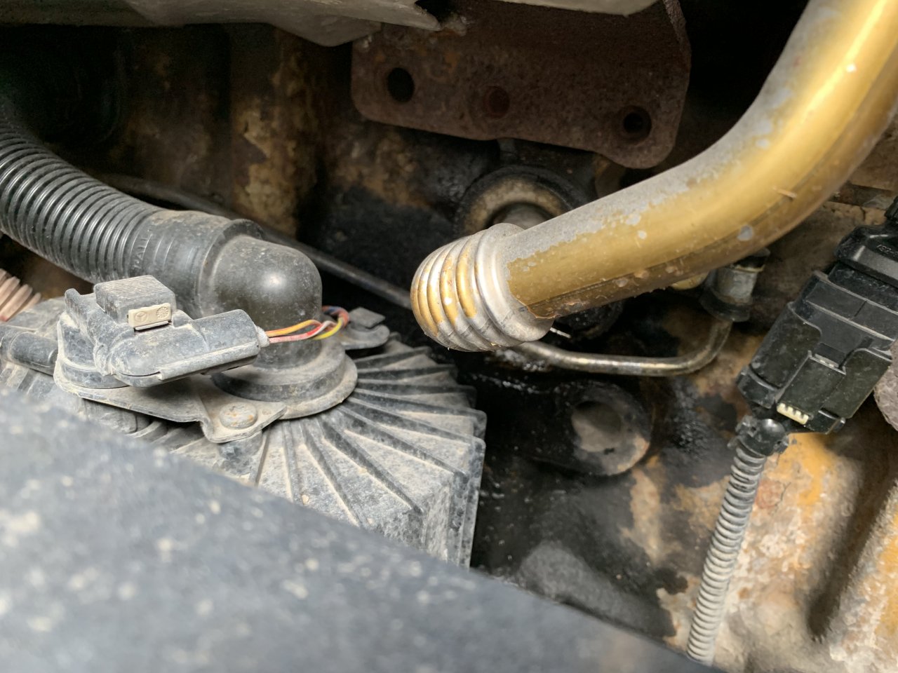

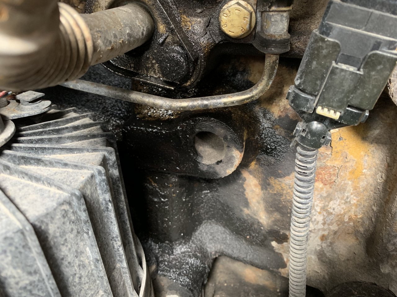

    Ive found leakage in my truck please advise where this oil is coming from.

    Get a can of brake cleaner and clean the area up and then run it a little while.. you should be a to pin point where it’s coming from..

    So you see where its leaking from, and want us to do what?

    Wash the engine with water or brake cleaner. Open the hood, run the engine, and see where it’s coming from.
    If I experience power loss I’d take it to a dealer immediately. Sometimes it could be a gasket, you lose a lot of oil but doesn’t affect performance. If that’s the case then I’d run with it for a while, finish the run and then go to a dealer.

    My mechanic said its turbo drain pipe oring.

    that does look like a return line of some sorts going back into the block in the pics

    Its a o-ring. Half a hour of work by yourself. Since the line needs to be removed from turbo, gasket there should be replaced too.
    Nothing to do with idling.

    no need to take off the line. just removing bolt is enough. The tube is flexible. I have done it many times on trucks.
