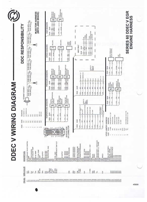

    Hi,
    I got flash code 27 on Freightliner Century 07.
    It`s Air Temperature Sensor open line.
    Do you know where I can find wiring diagram to locate the problem.
    I already check the sensor and it is working but it`s getting around 4 V on it.
    Thanks!!!

  5. Bush chook
    Bush chook Light Load Member
    144
    43
    Apr 27, 2009
    Geelong
    Hope this helps

    trs100 Thanks this.
  6. trs100
    trs100 Bobtail Member
    18
    3
    Jan 6, 2012
    OK I see that I have open circuit but I want to follow the wires to find the problem and I believe the problem is inside the cabin. But there are so many cables and it`s almost impossible to follow it.

    I,ll see if I can attach sections of the wiring diagram
  8. Bush chook
    144
    43
    Apr 27, 2009
    Geelong
    Here goes , hope it,s clear
    trs100 Thanks this.

    Sorry I think you need this

    And this also

    Is this for Century or for Cascadia?
    I can give you the VIN if it helps.
