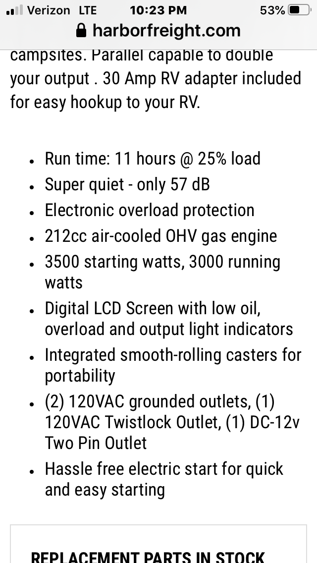

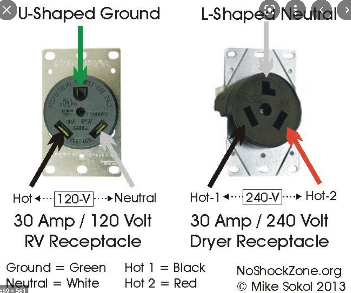

    Red, I'm thinking the big plug on his generator is 30a 110v, not 240. 240v plugs (dryer plugs) are the 4 wire bad boys and are 50 amp.
    Bigger portable generators like his are made for running RV air conditioners, not for a 240v appliance. This may have been what you meant by two wires above at 240v (120 each), just trying to clarify.

    Sure enough, it’s a 30 amp 120v. Like the one on the left. It says it will double the output. How’s that work?

    I'm no expert but my understanding is it basically just lets you run bigger/more 120v appliances, not run a 240v one. RV air conditioners are just heavy 120v appliances, which is the only thing I can think of that these big 30 amp plugs are put on portable generators for.

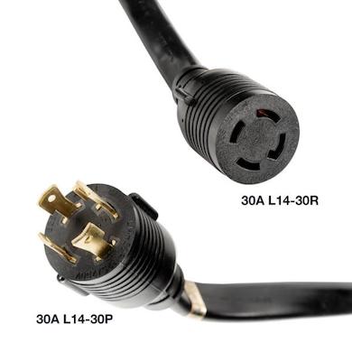

    Good catch. I did not look up the exact model and was going off what my own Chinesium 6500W genset at home is equipped with. It uses a patch cord like this one. I have a manual transfer switch in my garage that breaks out each 120V leg and has a watt meter on each one to make it easier to see the load and balance the legs.
    The twist lock is made for a patch cord application, but there's dozens of multi purpose "converter" cords of all types that will plug into one. For example, if you wanted to plug in a big window ac unit that would likely have a 240V 20A cord on it, you'd use one like this (on a 240V outlet like my genset has, not the one in this thread).
    Whatever is easiest. It's a single 120V feed. Splitting it inside the cab gives you the benefit of a single patch cord instead of two. The twist-lock connector also being more secure. It won't matter how you split it, only that the load is supported by an adequate gauge wire and outlets. The 30A patch cord sold at HF is 10 AWG and you could do two 15A circuits and outlets with 14-2 w/gnd romex. The balance on them wouldn't make any difference as long as the individual load is <1800W and total load stays under the 3000W genset max.
