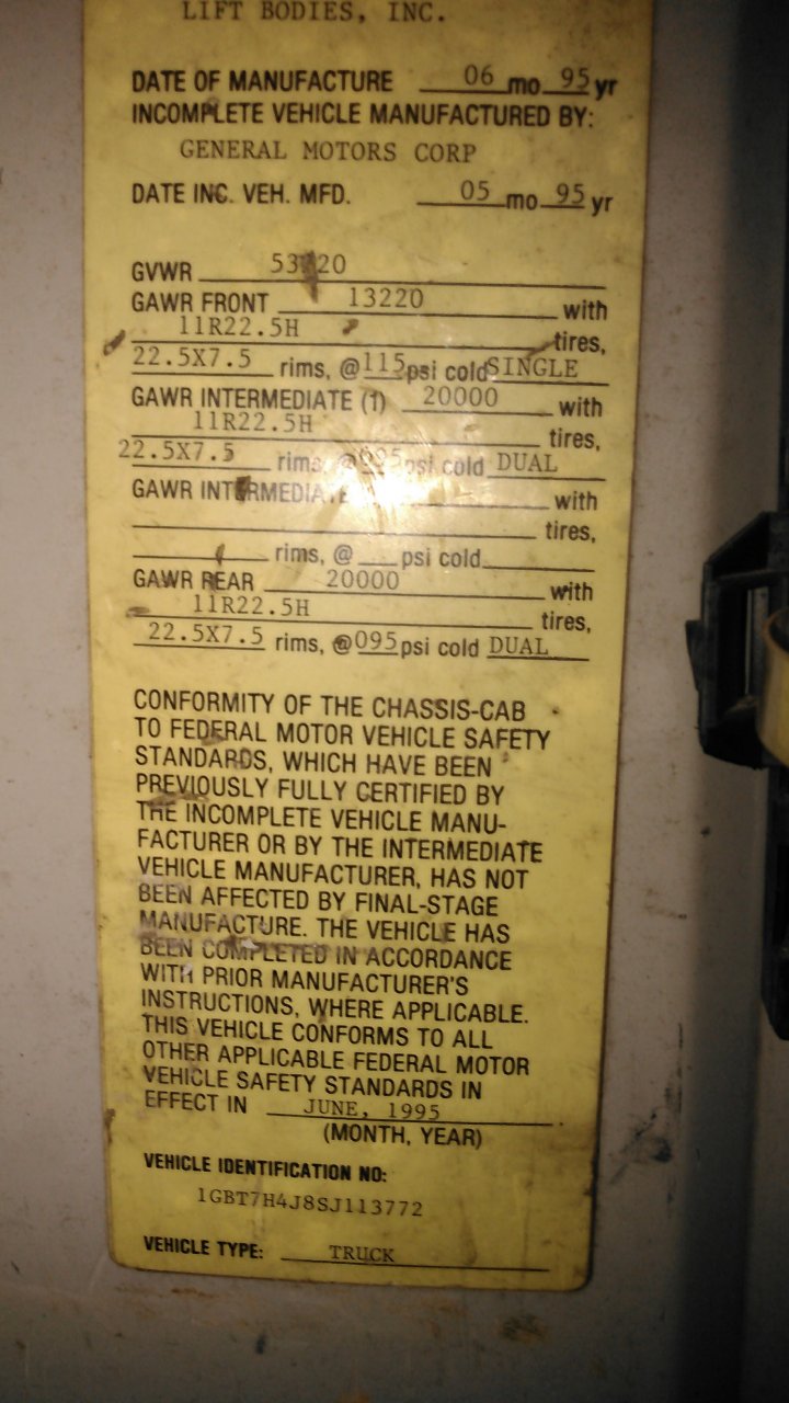

    I bought a Columbia from TAG last year. I had absolutely no problem registering it and the title work was fine.
    The issue I just caught is that the Freightliner VIN tag doesn't show the RAWR and the GVWR is only 12,000 lbs, since the only axle it came from factory with was the 12,000 lb front axle.
    This all came to light when a guy tried to get his CDL in the truck and the examiner said he couldn't use it.
    I can not find any other tags on the truck that show anything different.
    I've got calls in to TAG but in the meantime I figured someone else has to have run into this situation.
  3. Mnmover99
    Mnmover99 Light Load Member
    248
    344
    Oct 22, 2022
    Whoever built the glider needs to make a vin plate that is correct.

  4. Todd727
    Todd727 Medium Load Member
    300
    583
    Jun 7, 2021
    I'm afraid that the truck was ordered by an individual and he completed the build. Never even considered that until now.

  7. Todd727
    300
    583
    Jun 7, 2021
    I'm kind of at that point and was actually looking for those tags. I researched NTEA documents and it seems there isn't as much oversight as I thought. Waiting on Lonestar to get back to me though.

  10. Todd727
    300
    583
    Jun 7, 2021
    Has nothing to do with being a glider. Truck is great, just needed to see if anyone had faced the issue of getting a non-rolling glider.
    Think we have it figured out and the missing paperwork has been found.
    Thanks to those who helped.
  11. Ridgeline
    Ridgeline Road Train Member
    22,719
    123,193
    Michigan
    get the axle model numbers if you can to identify the drives and keep that documentation on hand. You won't get hassled if you are under the nominal weight limt.
