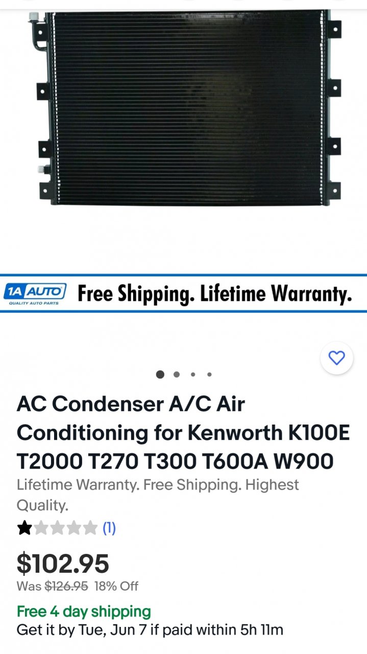

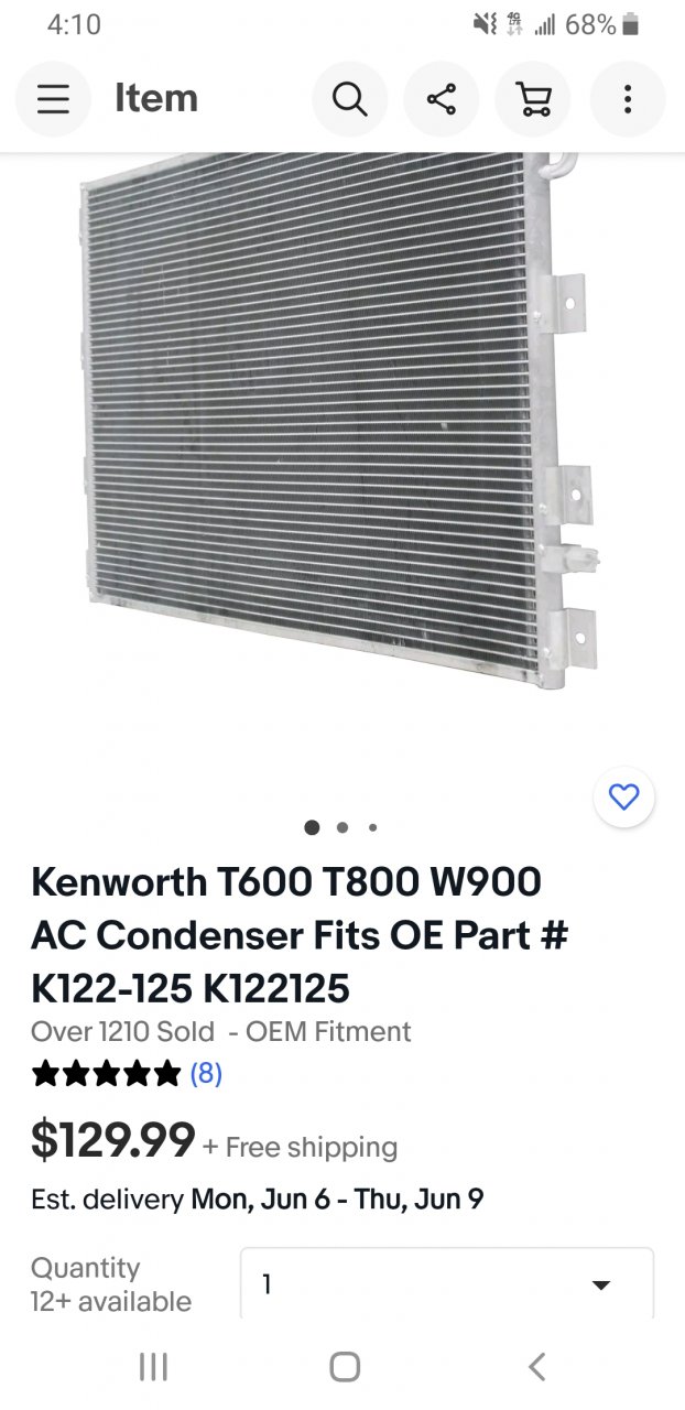

    Spied this part on Ebay. Look up Kenworth parts condenser.

    Thanks. I did see that during my preliminary search but it's not the right part number. Maybe I can retrofit it if I go that route.

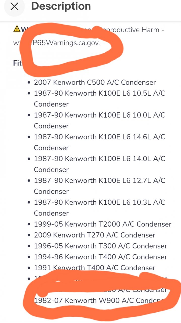

    This claims to fit a W900. It even has a P65 warning from California. You know you can't beat that with a stick.

    JB Weld isn't going to work here and that condenser in the pic is not the one in my truck. I can see it. They're completely different. I have a grill that's an actual condenser. The people selling that pos probably don't even have Paccar trucks in their country.
