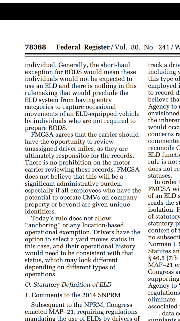

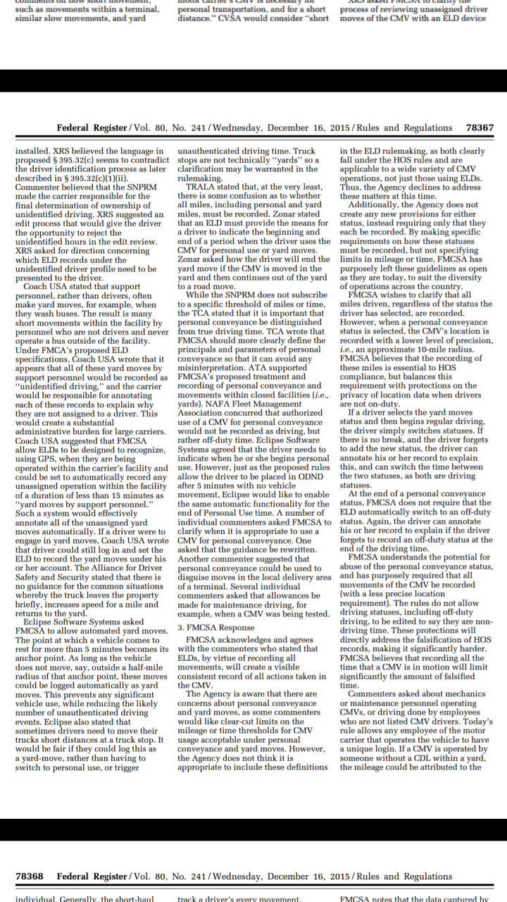

    I'm not going to copy and paste this because its multi page and substantial but I'll add the screenshots if you care to enlarge it and read it yourself but here's a few excerpts.
    Through testing with hundreds of
    drivers, Schneider found that having
    driving status trigger only off of a speed
    threshold without an additional mileage
    threshold is detrimental to the ELD. It
    recommended that FMCSA change the
    appendix to subpart B of part 395,
    section 4.3.1.2, paragraph (1) to read
    ‘‘[o]nce the vehicle speed exceeds the
    set speed threshold OR the vehicle
    travels more than 1.5 miles, it is
    considered in motion.’’ The commenter
    believed this avoids the potential for a
    tractor to move 20 miles at 2 miles per
    hour without showing any driving time.
    Also, in section 4.3.1.2, paragraph (2),
    Schneider suggested the vehicle should
    be considered stopped when the speed
    reaches 0 miles per hour AND the unit
    stays at 0 miles per hour for 5 minutes,
    rather than the proposed ‘‘3 consecutive
    seconds.’’ Commenter wrote that to
    leave the threshold at 3 seconds as the
    rule proposes will result in invalid duty
    status changes.
    Coach USA stated that support
    personnel, rather than drivers, often
    make yard moves, for example, when
    they wash buses. The result is many
    short movements within the facility by
    personnel who are not drivers and never
    operate a bus outside of the facility.
    Under FMCA’s proposed ELD
    specifications, Coach USA wrote that it
    appears that all of these yard moves by
    support personnel would be recorded as ‘‘unidentified driving,’’ and the carrier
    would be responsible for annotating
    each of these records to explain why
    they are not assigned to a driver. This
    would create a substantial
    administrative burden for large carriers.
    FMCSA Response
    FMCSA acknowledges and agrees
    with the commenters who stated that
    ELDs, by virtue of recording all
    movements, will create a visible
    consistent record of all actions taken in
    the CMV.
    The Agency is aware that there are
    concerns about personal conveyance
    and yard moves, as some commenters
    would like clear-cut limits on the
    mileage or time thresholds for CMV
    usage acceptable under personal
    conveyance and yard moves. However,
    the Agency does not think it is
    appropriate to include these definitions
    in the ELD rulemaking, as both clearly
    fall under the HOS rules and are
    applicable to a wide variety of CMV
    operations, not just those using ELDs.
    Thus, the Agency declines to address
    these matters at this time
