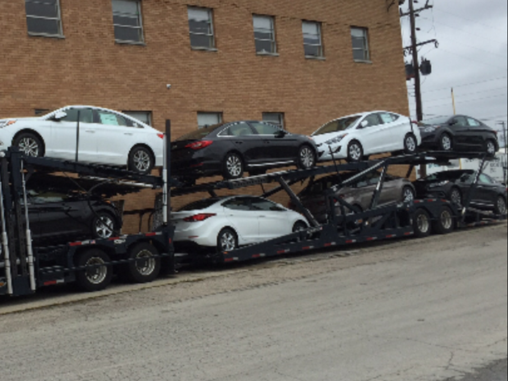

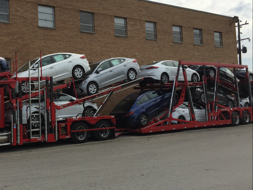

    These are very similar cars on the load. The bottom picture I could have hauled an extra car on the tractor but it would have been too close to the first one on the trailer to make it worth the risk for me. If you are paid by the car or percentage you will want a highrail. A highrail takes longer to learn, but when you do learn it you can do much more with it vs a quick loader. If you only do short haul's and multiple loads a day you will want a "quick loader". The term quick loader really depends on the person loading it, not the truck. When I first started hauling cars a 70 year old very experienced car hauler could routinely load his high rail and be long gone before I could load my quick loader. Now I can load my highrail almost as fast as he did, but not quite as fast. He had many more years of experience than I do.
