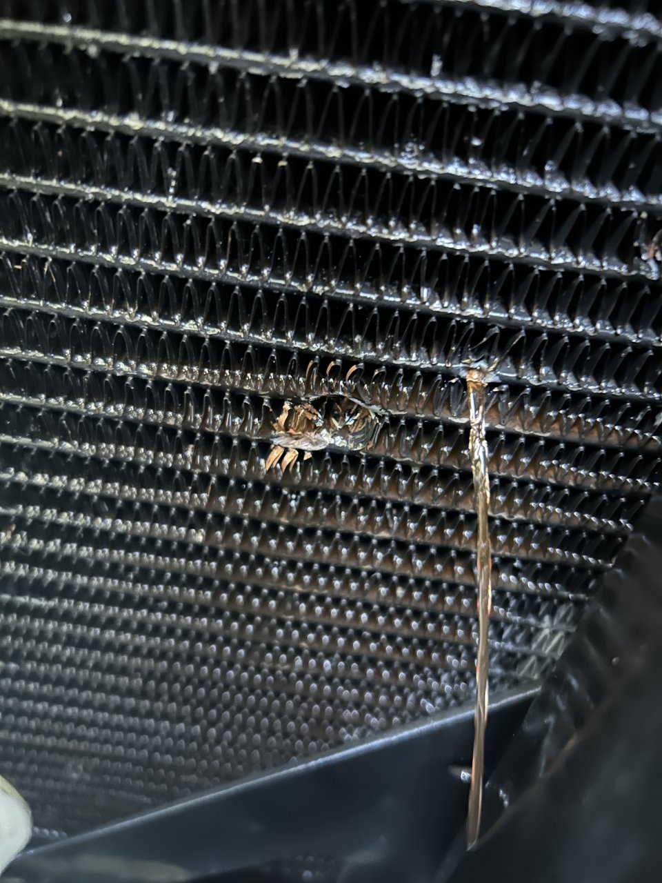

    676CD920-3B16-4227-A5B4-47D3DFE26016.jpeg My bargain radiator was’t such a bargain after all. Only 2 yrs old. Any ideas on how to patch it? Temporarily fix?

    Can’t blame the rad for that as it was clearly hit by something. Seen it happen to brand new radiators.
    Drain it dry and JB weld?

    Needle nose plier, squeeze the tubes shut on both sides, then stop leak additives in the coolant.

    if i were you, i'd do the needle nose pliers trick, then get it professionally fixed, then install a metal screen (like a screen door screen) behind the grille to help stave off this from happening again.
    you clearly got a HUGE dent just below and to the left.....something hit you, the radiator did not fail, YOU FAILED, by not having protection in front of it, to stave this off...

    epoxy puddy get at auto parts store works great

    Easy fix drain it solder it done deal

    Solder would be the best repair. Is there a rad shop near you?
    It would be a minor job for them and as good as new afterwards.

    I’m under a load that delivers in the morning. I agree something hit it. Needle nose pliers trick sound interesting. I tried a screw and rubber washer. No good. Can’t find my JB weld. Got a bunch of it somewhere. All different types. I’m 9 1/2 hrs from delivery, due in 121/2 hrs. I stuck some cat gut type sticky gkue off the back of some some sound deadening material. Put a plastic plate over it . Used zip ties. It quit. Took off and 4 miles and shut down. Came back only 1 gallon low. Quit leaking. I’m hesitant to Even touch it. Only have 4 jugs for water. Don’t want to cook the head/gasket. I need to drain it to use the JB. I’m in a bad spot. Better place at my destination. I’d rather run with it, putting a couple gallons every 1-2 hrs if needed. Get empty. Don’t reload till later on Sunday. I need to get home. Tip;: Never work on your Biirthday Lol. Couldn’t find any shrapnel from the alternator anywhere. I doubt that’s what did it. Took the belt off yesterday at 4:00 pm to avoid that. Something hit it, fan must have been engaged to cause that on the inside. Other spot looks damaged worse, but isnt leaking. Well it hasn’t shut off yet. It was barely leaking. Maybe had some air pockets. I’m going for it again. Get more gallon jugs ASAP.

    If you now how to sweat copper pipe fittings then you can solder it. I’ve fixed one or two radiators and many old un-replaceable no aftermarket available heater cores that way.

    I just use a propane torch and acid core solder for plumbing.
    Drain it. Clean with alcohol . Wire brush. Pinch it off a bit if big. Heat up and hit with a little solder. Problem solved.
    Just fixed mine a few weeks ago.
    Also, a bit pricey these days but duraglass will stick. O'Reilly sells it under a few names. It is long strand fiberglass. In the Bondo section. Clean it good , dry it. Mix a little and shove it on. Drys fast if you do not use too much harder. Should be a ;ight blue after mixing or maybe pink if red hardner.
    I use it a lot for stuff. It don't come off. I used to be a body man.
