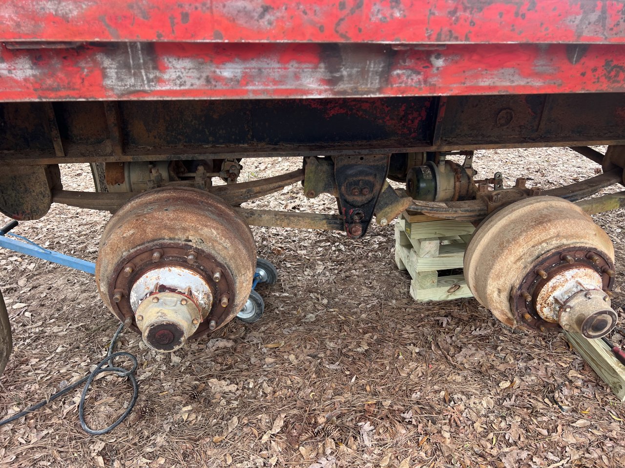

    Seller didn’t have any info on it. He bought it 20 years ago. This is the first trailer I’ve bought and I’m not too familiar with the options I have. Figured i would need a plate in order to have it inspected.

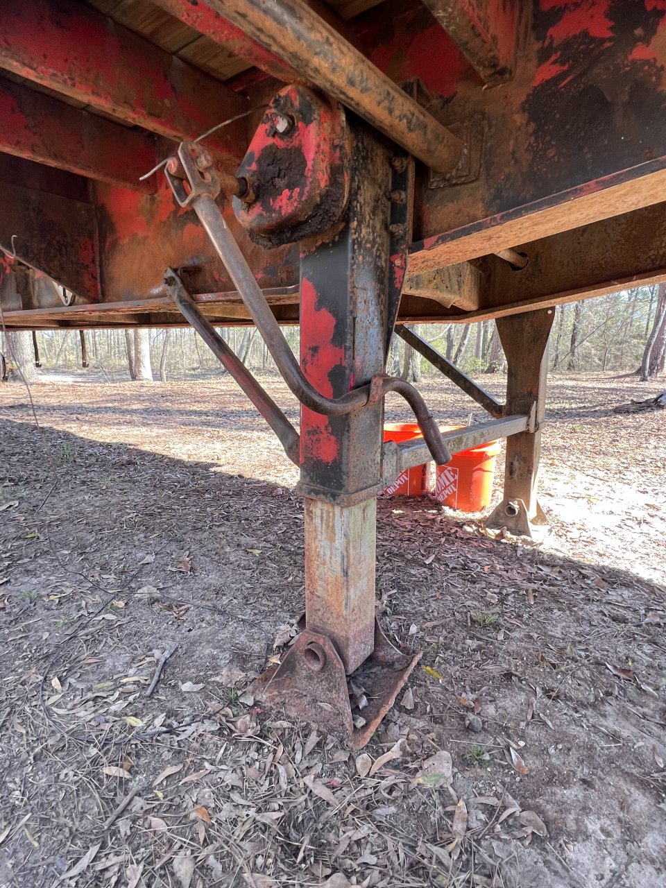

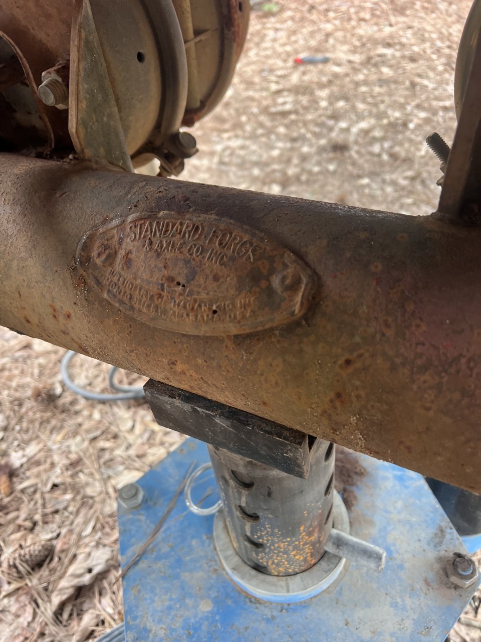

    Standard Forge Axle was a supplier for both Trailmobile and Great dane. They were the ones you got when you ordered Budd type hubs and wheels. Lufkin used Hobbs/Fruehauf axles. What do the taillights look like? Lufkin used there own design back then. Lufkins were two square per side Trailmobile sometimes used three 4” round per side instead of the two everyone else used.

    Ok. Just did some more research and pulled some books. Starting in the 80’s Lufkin was using 4” round taillights on their flats with three per side optional. It seems for awhile Lufkin and Trailmobile were in bed together in an attempt to cover more sales territory east and were building almost like trailers for awhile. I can’t find any rock solid info on the landing gear. Both Fruehauf and Dane made there own and supplied them to others. Holland basically ended up with Fruehauf's after they bankrupted. So may not be able to get much of a clue from them.

    Tail lights are 4 inch round. 2 on the left and 2 on the right

    Landing gear had been painted over but I found some info stamped on them.
    The Binkley Co
    Warrenton, MO
    Model 50000-3
    SmallPackage Thanks this.
