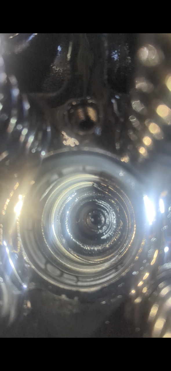

    Yes that's a different cylinder which has no leaks. The one that's black inside is the one that has no o ring or graphite here is the pic Screenshot_20231216-213938.png

    Screenshot_20231216-215856.png Here another angle hope it's a better pic I just cleaned the injector and it was coated with soot

    Gotcha. Definitely see it there

    What say you on the injector cup most likely issue?

    if the injector bolt was loose i don't see anything wrong with cup more than likely you're dealing with a blown head gasket

    PXL_20231219_235226573.jpg Just an update cup on cylinder 5 was bad I pressure tested it and it was blowing air through it. Took the head off had it pressure tested confirmed cup on 5 was bad. Cost me 650$ to do pressure test and 6 new cups

    @Big Road Skateboard knows his ####. I’d be very glad if that’s what’s wrong with mine. You got lucky. New heads have gone up about 50% in last 3 years. $650, not bad. Add gasket set, O rings, and what else? Total cost? Whatever, better than $3-$4k. 5-6k with labor these days.

    Bought gasket set online for 210$ including all injector o rings got head bolts for 165$ check valve was bad 130$ new cups+ test 650$
