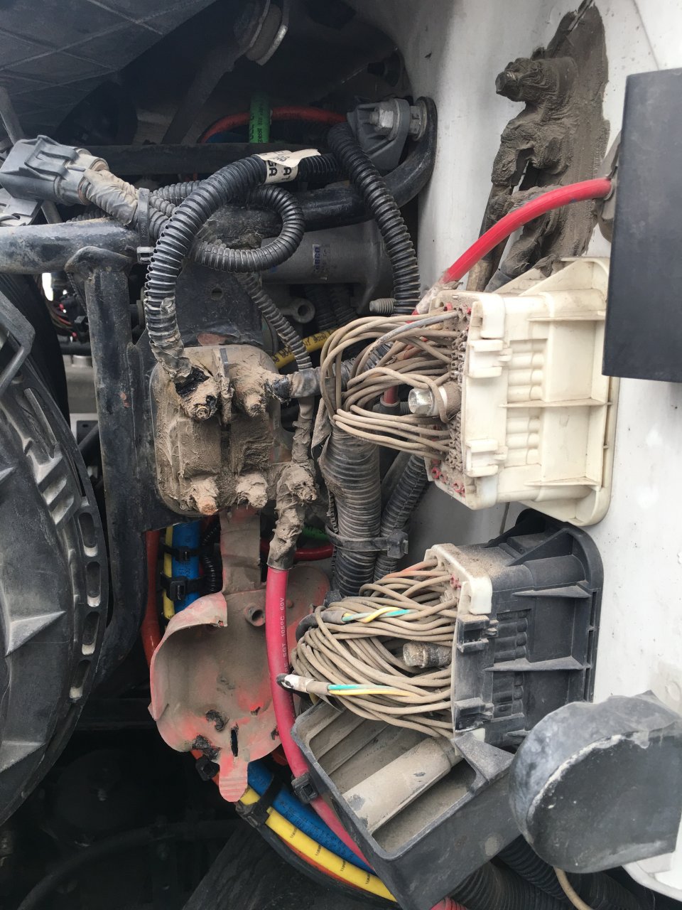

    Check the main power cable to the body controller. It goes from the mega fuses on the fire wall to the top of the body controller to the left of the clutch pedal. Make sure you didn't blow a mega fuse and that you have good power to the body controller.

    Which one is the main power cable? There is two power cable in the center of the cluster module? And how do I check the mega fuse?

    The main power cable for the body controller is the red cable that goes through the firewall by itself above the big white connector.

    Might also have a main ignition relay not working, but those gauges that are not working are feed data from the body controller.

    It has 12 volts, somehow the fuse panel for the power mirrors and windows ohms out with one of the plus for the cluster. Top right plug if look over the top of the cluster. Three terminals in that plug ohm to the power mirror and window slots for the fuse panel. When we pull out the power mirror circuit breaker the abs, traction control and check engine light come on on the dash, when we put the circuit break back in they go off
