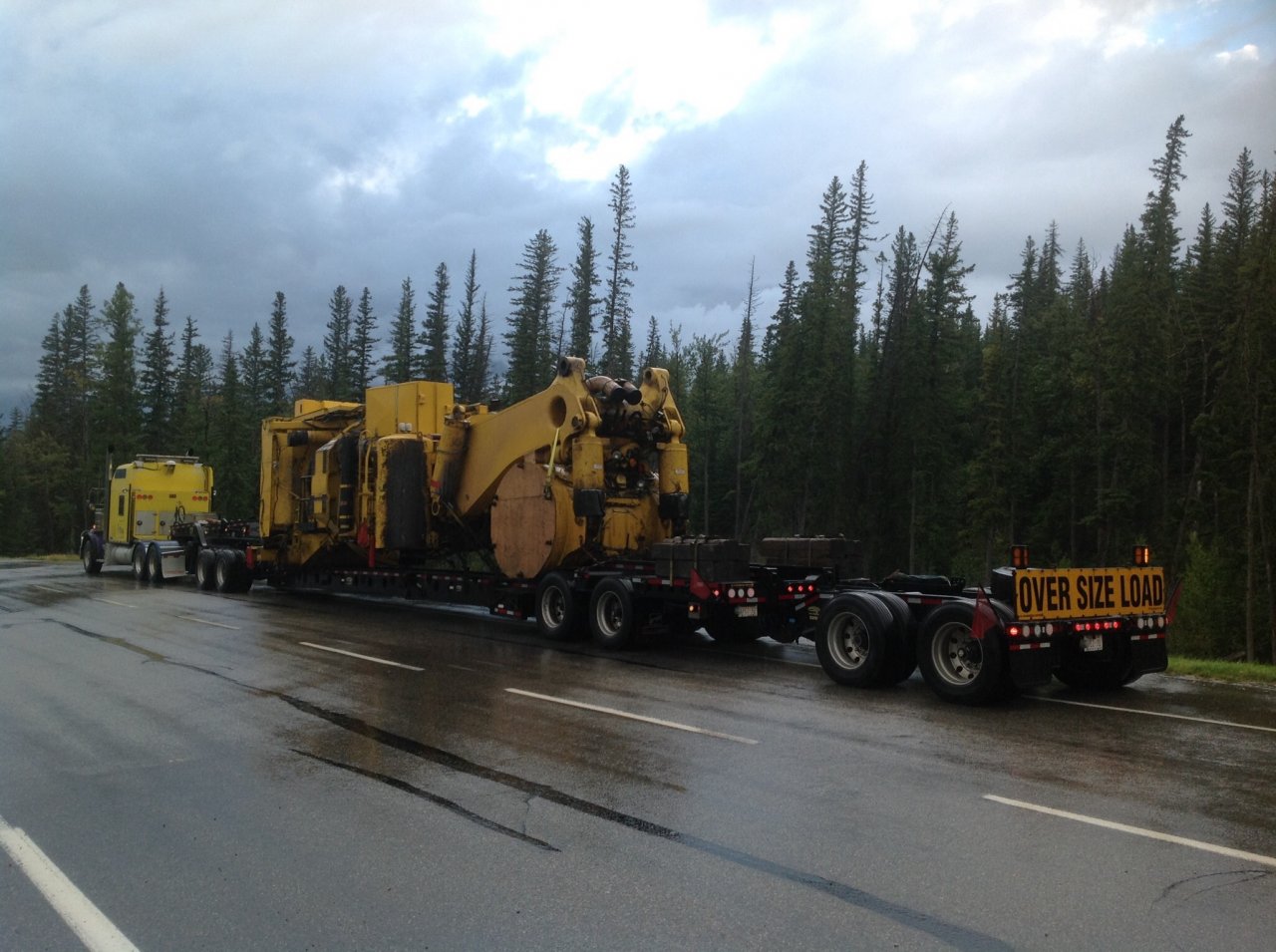

    I would like to comment on the securement.
    I'm quite well known for being a securement jerk.
    But the photos don't demonstrate anything I can definatley point to to critique. I don't know you, nor do I know your work, but you yourself stated

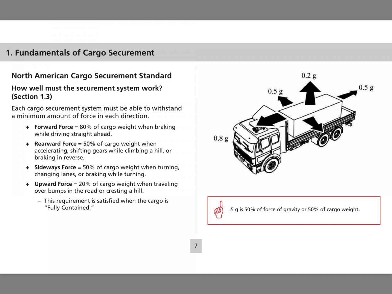

    I have no clue of that which I speak...
    It's only >117,000lbs.
    However, I think 20% is way too low. A high center of gravity load will easily overtake a meager 20% during a good lean.
    The above diagram is also somewhat deceiving, as the 80% of forward momentum force indicated by the arrow actually means 80% of rearward pulling chain to prevent the forward movement. You would be quite surprised how many people can't figure this out.

    It's
    on a side note that rule applies to breaking strength not WWL.
