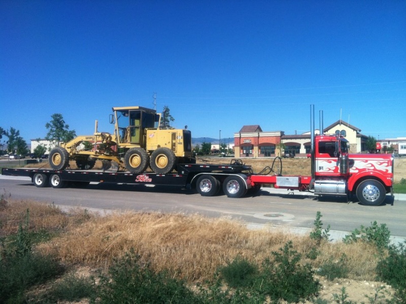

    One of my buddy has been slowly restoring his 76 B model. He did the cab last winter and installed the daylight doors with electric windows. Took him 40 hours each door to fit perfectly (he's a perfectionist).
    Before:
    After:
    JoeyJunk Thanks this.

    that is loooking pretty good, i was thinking of doing somthing like that with mine for the doors. so did he swap the whole cab or just the doors?
  5. 58Skylane
    58Skylane Medium Load Member
    388
    276
    Mar 31, 2012
    Cody, WY
    Just the doors. He had to do a lot of trimming to make them fit the way he wanted them to fit. There's a perfect gap all around the door jam. It'll be a while, but I'll get some close up pictures and more info.
