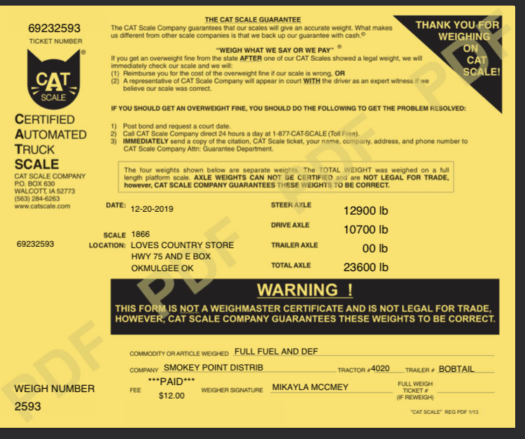

    I don’t get it. A shallower pin setting would allow you to get more weight up front because you can slide the fifth wheel farther forward before getting into your landing gear. Most modern things trucks have so much emissions stuff up front steer axle weight in not an issue. I Usually run my fifth wheel centered over the rear axle, this load I slid forward about a foot because I knew the load would be heavy.
    I rolled over the scale with a full tank of fuel and only the front 16k pound lift on, just under 13k. I should have left it back. F8D9AD43-5075-4078-9360-0EF2EF24C255.jpeg

    Tag axles are behind the drives, I believe you’re referring to a pusher axle. If you need a deep kingpin to load the front axle why do rgns have very shallow kingpins?
    I know how to load my equipment just fine. I pull all different types of trailers, that’s why I have 4’ of slide that starts at the rear of the frame. Try pulling a 16’ wide trailer with your 5th wheel centered over your drives. It gets ugly quick.
    Edit to add: I reread your post, it’s obvious you didn’t read mine. I’m 12,900 on the steer bobtail. I don’t need to transfer weight forward.
