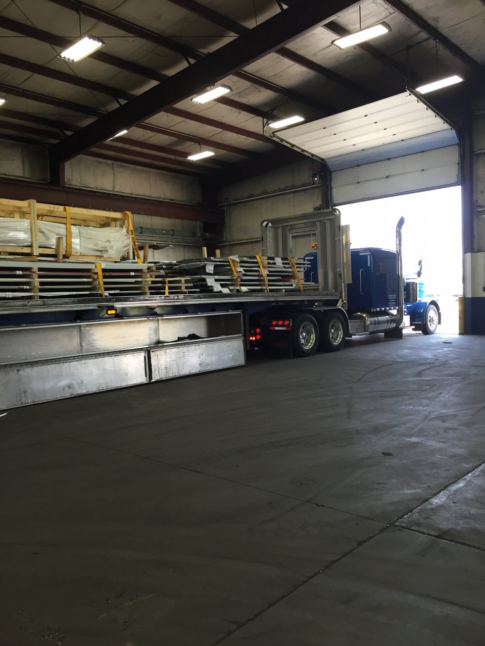

Speaking of load placement. Loaded this 1 foot ahead of centre. I was almost bang on with weights. 800lbs heavy on the trailer but o well. I was getting a permit anyways.
