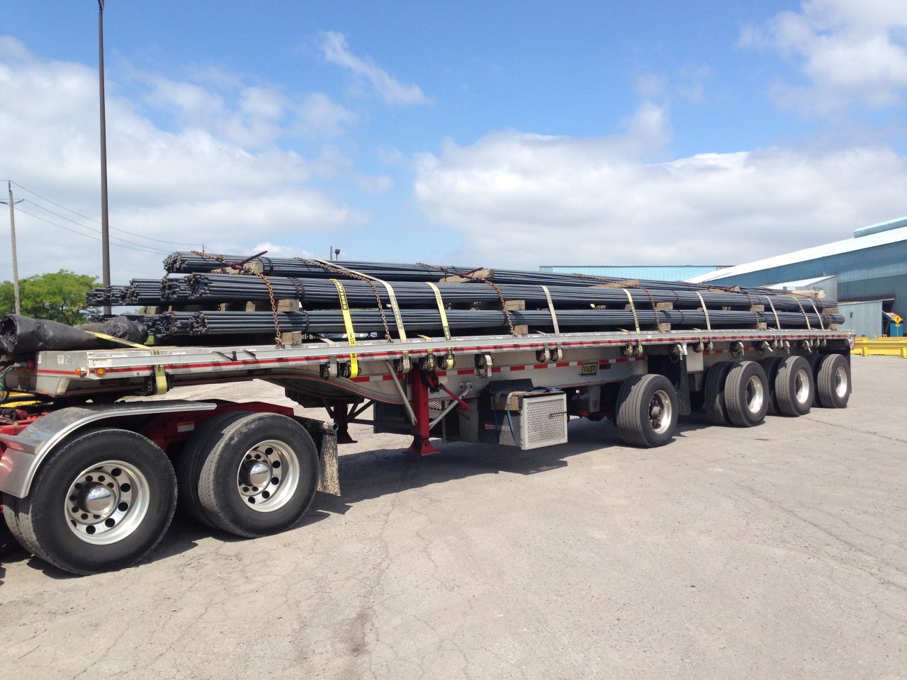

    Ok, might have been the wrong thread but I'll blame it on the heat exhaustion. I had the opportunity to taste the same water twice, on the way down then on the way back up!
    While we're here... That material is offset about 1.5 feet towards the back.
    38" of deck at the front and a few inches at the back. The top single bundle is back an additional 1' because I could tell by the gauges before it was set down that it would need it (and the crane operator started the rest of it slightly further forward than I wanted).
    My drives scales at 40,160 lbs (40,000 lbs allowed) with fuel to burn.
    Chewy352 Thanks this.
  7. Chewy352
    Chewy352 Road Train Member
    1,797
    11,619
    Dec 17, 2013
    Enid, OK
    What were your trailer weights? What's allowed?
  8. Dye Guardian
    Dye Guardian Road Train Member
    1,329
    12,583
    Jan 10, 2015
    North
    74,160 lbs on the trailer, 74,900 lbs allowed. I'd say that's not bad!
    MJ1657 and Chewy352 Thank this.
