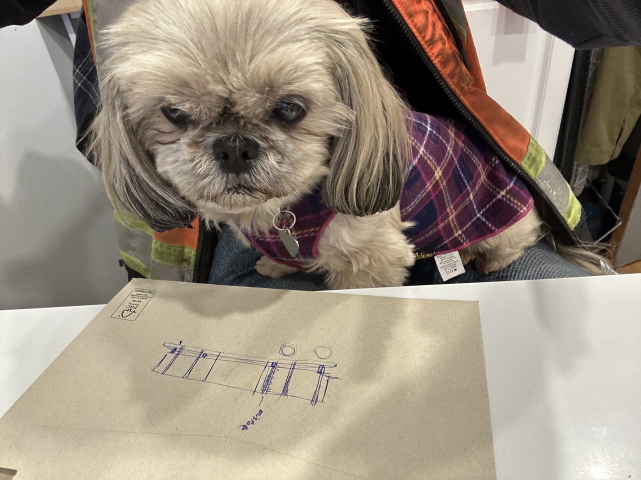

    “A strap for every ten feet” means the FMCSA does not dictate where you put your straps latterly.
  8. Carpenter Scotty
    Carpenter Scotty Road Train Member
    1,636
    19,637
    May 11, 2025
    Montreal
    Powder Joints and TripleSix Thank this.
  9. TripleSix
    19,171
    134,019
    Dunnage in the center has a really good chance of walking out while you’re driving. Imagine an 8 ft piece of 4x4 lumber coming off of your trailer at highway speeds. If that structural piece isn’t heavy enough to flatten out the trailer, the dunnage in the center may walk.
    A 40ft container, empty, will not have enough weight to take the arch out of a trailer. A heavily loaded container will.
    On your illustration, I would put 1 dunnage for each end and securement on either side of the dunnage, enough securement to cover the regs for the length. Also, your securement in your drawing, is it direct securement or indirect? Don’t just answer, find out…you will have to know.
    Carried a 60ft light pole on a stretch RGN. A structural piece. The base was 10ft diameter. The end was 7ft. Because the pole was round, I set the dunnage in coil racks, set vertical to the trailer. Any securement in the center will be flung off. Any dunnage in the center will walk. There’s so much flex in a stretch trailer that it’s almost impossible to secure the center.
  10. Carpenter Scotty
    1,636
    19,637
    May 11, 2025
    Montreal
    IMG_1086.jpeg Ideally indirect, over the top and back down to the trailer if something like I beams with gussets and joining flanges. As I understand it direct would increase the amount of effective load by reducing the effective wll of the securement, requiring bigger/more chains.
    Also tricky to do direct with a few pieces on there, would imagine it being easier to go over the load provided the layers are properly blocked upon each other.
    Thanks again for taking your time/sharing your knowledge
    Reason for edit: Had help, but it was unqualified/ added photo
    Lonesome and TripleSix Thank this.
  11. TripleSix
    19,171
    134,019
    Very good. Easiest way to think about it is Direct=Direction. For example, heavy machinery over 10000lbs requires a minimum of 4 points of securement. If you pull all 4 points forward towards the front, is there any securement preventing the machine from shifting forward? The reason why direct securement has 50% less WLL than indirect is because without the opposing pull, you only have half the securement needed to prevent shifting.
